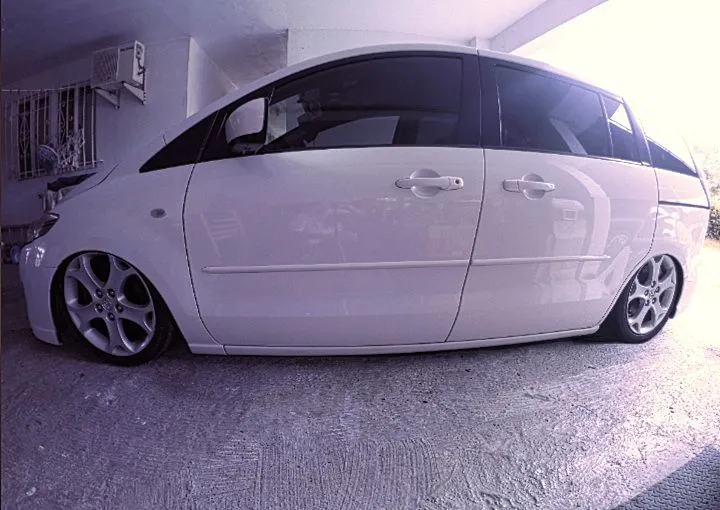

A quick side shot of our Mazda5'Premacy
So can you drive that low? How's the turning you rub? Thanks for the side shot
Thanks. I was hoping for more technical details. Did you get custom springs made or are they off the shelf by some mfg? OR did you mod/cut/heat treat and reform a kit spring? What is the free length and spring rate of these springs?Rears:custom spring rates and length/non adjustable ride height w/adjustable rear shock cartridges/moogs adjustable upper arms.
Fronts:custom spring rates and length /adjustable strut cartridges/customed-fitted FortuneAuto sealed thrust needle roller bearings/onikyan plates/adjustable front links/2-point strut tower bar
What brand shocks/struts did you use in the CO build (Im assuming FortuneAuto kit?)? There arent many adjustable damper options avail in the Mazda world. Would be good to know who else is out there, especially in Asia/Pacific. How much stroke travel in the front/rear do you have work with?
