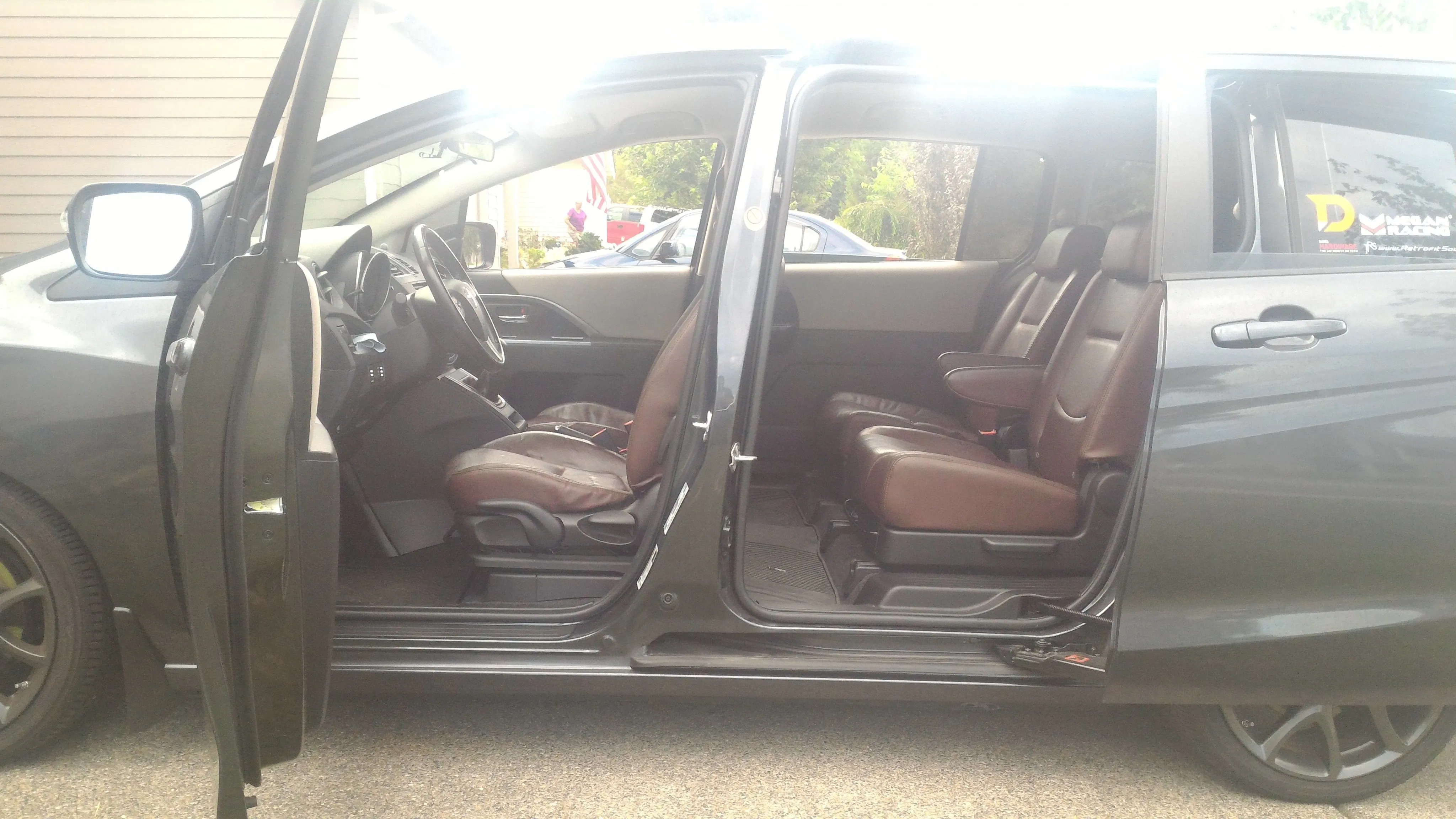

Got these from B&R Autowrecking. They're a little dirty but they're the brown leather seats from a first gen that I've always wanted. My 2014 has cloth seats that suck ass. These are just the fronts, getting the rears tomorrow.

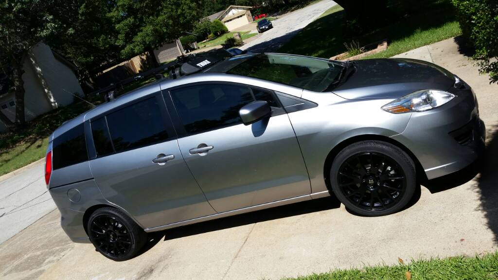

So.....I got new tires on my wheels. The 245/40/18s were rubbing a bit even after the fender pull.
So now on to 225/40/18s. Almost identical rolling diameter to stock and ride great. Not to mention no rub and no "donk" look. Lol
Sent from my SM-G900V using Tapatalk
Nice. What offsets are the wheels?
18x8 with 32 offset. I had 245 and rolled the fenders, but they still rubbed. 225s are doing great and are damn near flush with the fenders. Love it! Now, to go moar low.

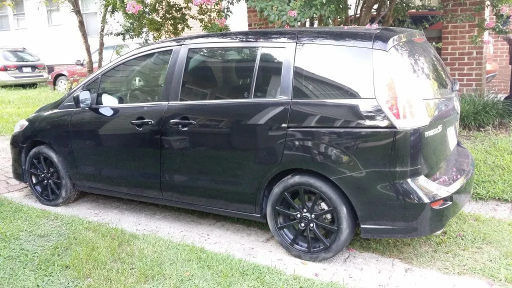

MX5 NC wheels installed.. painted by myself (not well). I was trying to avoid spending more to have them professionally done than what I spent to buy them...will eventually get them done...Tour Bus_resized.webp
One seat in! Was a big pain in the ass - had to swap the entire upper seat frame/foam and everything from the brown seats, swap the side airbag from the cloth seats into it, swap the seat pan from the cloth seats (brown seat pan had a lot of bad rust). Looks like the lower seat cushions are shorter but they might be better for me since I'm only 5'7". Will tackle the driver's side and rear seats tomorrow.

In that case, I'm one lucky dude to end up with that set up (cabpatch).. When I was looking for an MZ5 at the time, I didn't think much about MZ5 trim levels til I've read about it from other posts. The seats do come heated. I do wish it has an arm rest for the front passenger seat, and arm rests in the mid rear seats (door side)..
You are lucky, thats one sexy little van! Tuanies, the brown leather looks fabulous in your interior. I would love to be a fly on the wall at a car show as the Mazda wonks try to figure out how you got a stick shift Mazda5 with leather seats LOL
They also stopped offering the brown after 07 too, so that may be confusing :D.
Definitely a nice contrast with the beige interior trim. Btw, what did you use to get them filthy seats so clean??
Scrubbing bubbles lemon scent, 100% natural horsehair kiwi shoe brush, Griots leather rejuvenator and lots of patience.
