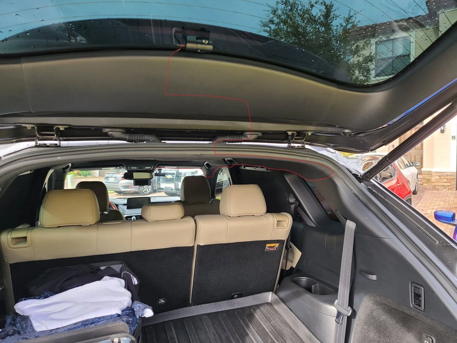

very eager to know how was the process in wiring the rear dash cam? I would love to install one in the rear of my cx9 but I don’t want to pay another 150 which is what it cost me to have a front kenwood dash cam installed lol
https://www.amazon.com (commissions earned), so the rear camera connects to the front camera and I just run the wire through the right side of the roof liner. The cable comes out in the middle of the rear side of the the roof liner, and I ran the wire into the hoses for the rear brake light so the cable is not visible

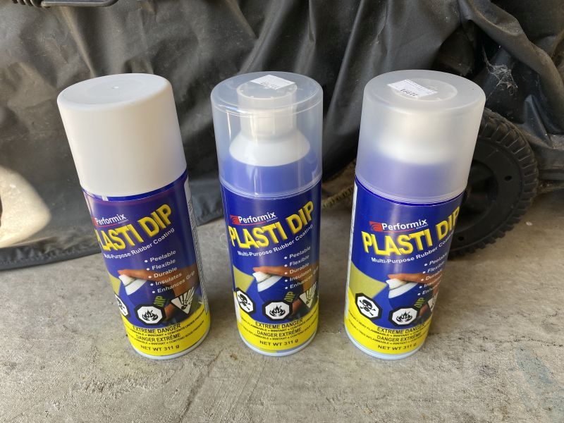

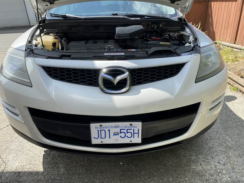

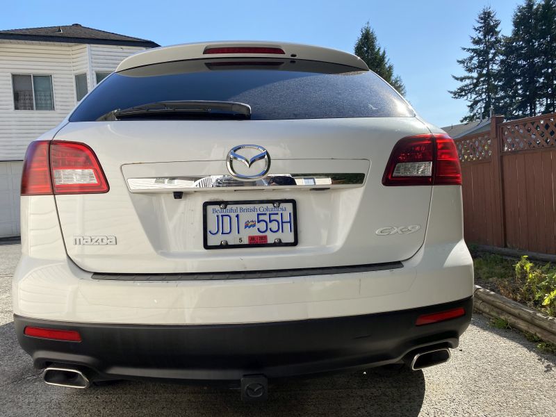

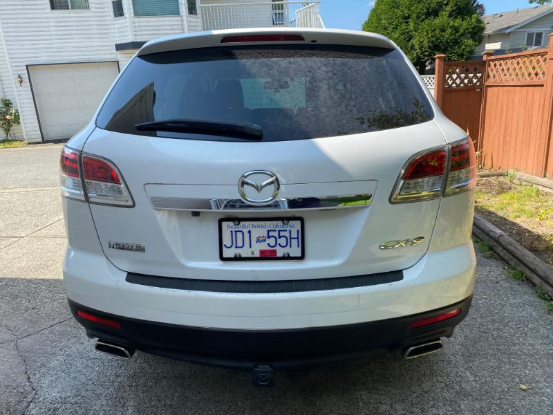

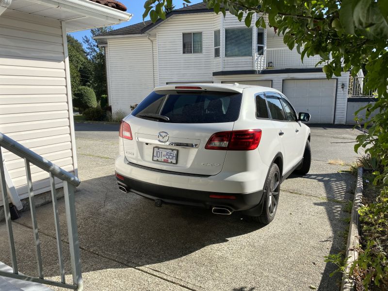

I hate chrome/clear tail lights,, and chrome badges. Today I puttered on the rear of the 9. VHT red nite-shades for the tail lights and white/gloss/clear Plasti-dip for two of the badges on the tailgate. Looks so much better.
Before:
After:
This is how I have mine wired up. If you're wiring up a new dashcam you can start from the fuse box and go from the left side instead of the right.
Hi, just a heads up - when you were running the wiring, did you ensure that your wiring runs behind the A-pillar and curtain airbags? If the wire is in front of the airbags, it can interfere with the way they deploy, making them prone to malfunctioning when you might need them. I had to run my wire from the camera to the base of the windshield and cross over there instead.
Those lights came out awesome!! Nice job on everything.
Thanks sm1ke. That was my first time using plasti dip, and it went fairly well. Learned a few things for the next time, and the 9 looks so much better. Door handles are next.

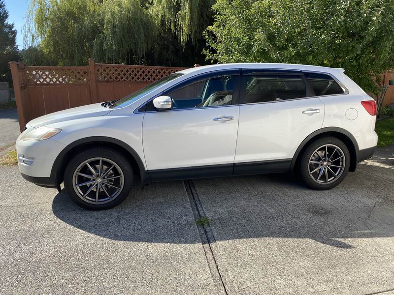

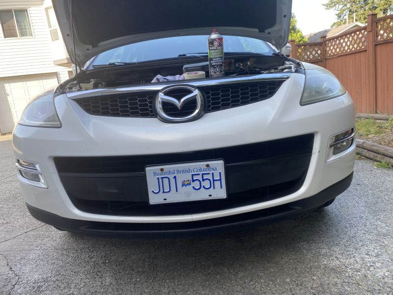

It's crazy how much of a difference the chrome bar delete makes on the front. It looks a lot cleaner now IMO.
Agreed. Thinking that the rear one will get done white also, then the front and rear Mazda logo will be black.

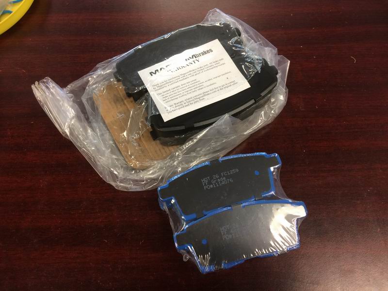

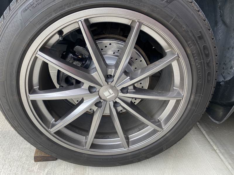

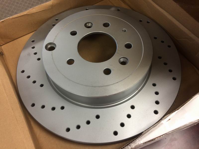

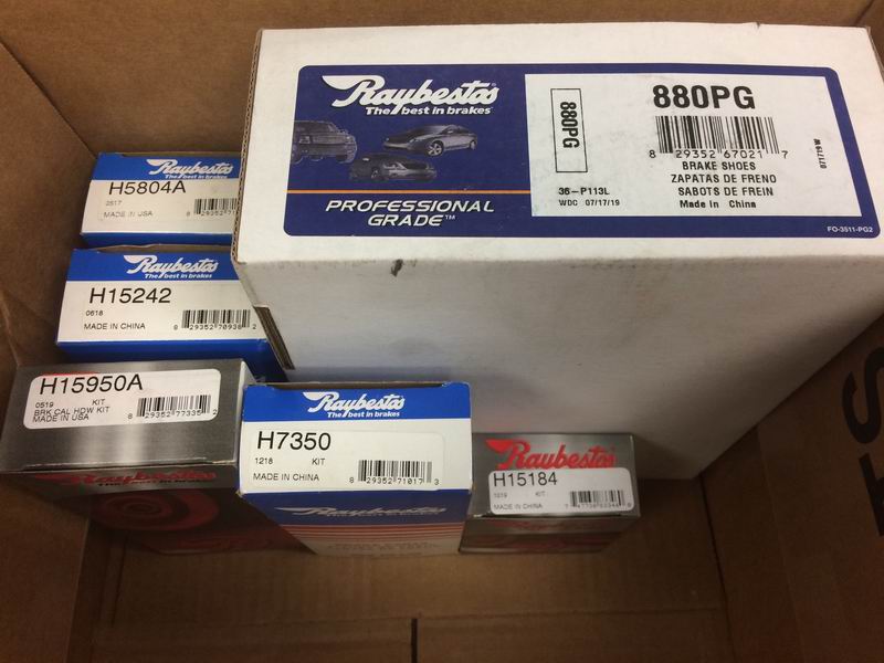

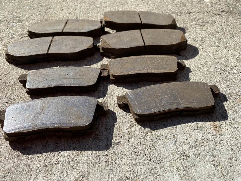

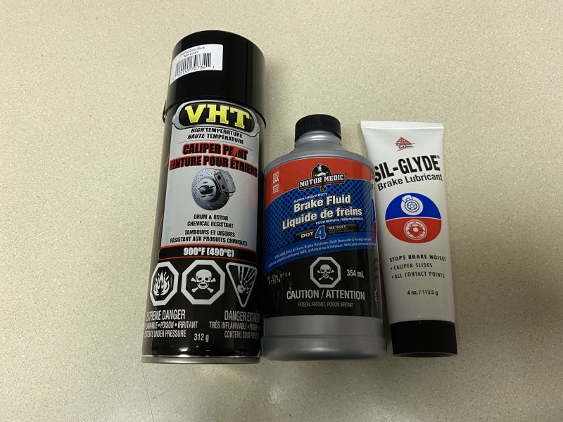

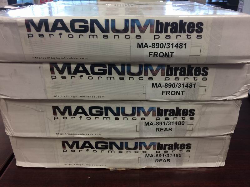

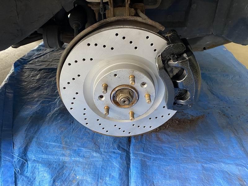

Did the brakes today. The old brakes pulsed, had no e-brake, and I new that the rear pads were very worn. Got some cross drilled rotors and ceramic pads from MagumBrake, Raybestos hardware and e-brake shoes. The e-brake was seized pretty bad, so good to have it working properly again. Did a good break-in and stopping feels great. Never used cross drilled; just hoping to not have any pulsing for a long while. Time will tell
The old stuff.

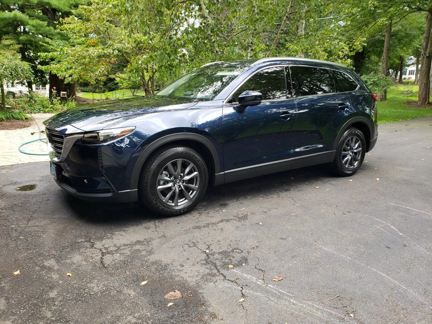

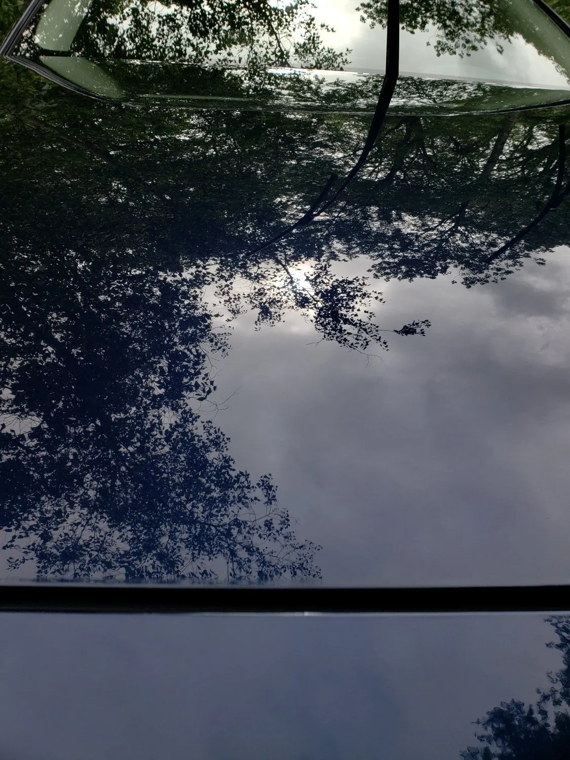

Whole bunch of detailing done today, not too much since I gotta go to work soon. Tried out Griots 3in1 ceramic wax stuff. Works pretty well from what I can tell. Still doesn't hold its own against even their Best of Show wax but, damnit, it was seriously easy to apply.
That good nice. What year is yours? I have a used 2017 I picked up a month ago and the paint wasn't the best kept. I did 1 pass each of compound and then polish on my DA. Then did a coat of blackfire ceramic sealant. Looks good but 3 years of neglect was hard to overcome with my hobbiest supply of materials.
2020 about a week and a half old. It sat at the port of Baltimore for a few months though due to covid and the dealership had construction going on. I hit it with griots complete compound after a full panel clay bar. Im still iffy about the spray on ceramic waxes but everyone swears by them so we shall see. Im going to predict im going to strip off the ceramic wax in a few weeks, polish, wax (paste-griots), then seal it all in with 2 nice coats of the ceramic wax.
