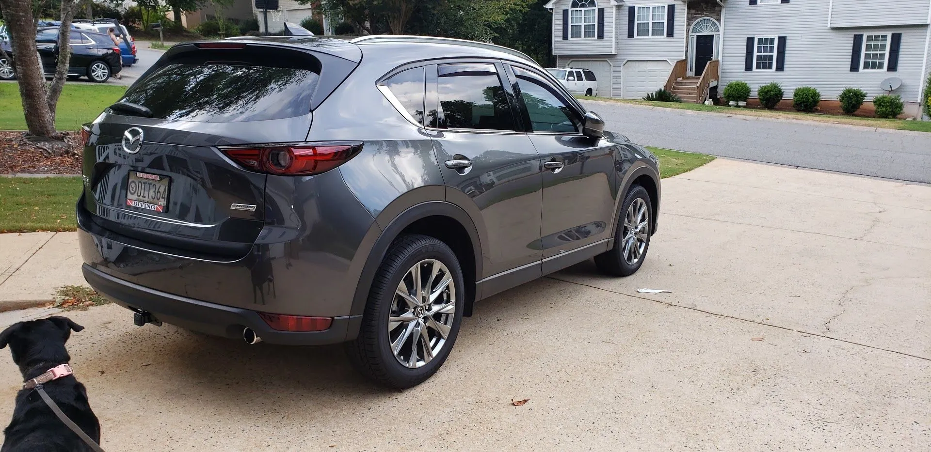

In the past week I got the OEM hitch installed (looking back, wish I wouldn't have since it cuts the bumper and is only the Class II hitch), got the legal tint on front windows, and put in the side window deflectors.
