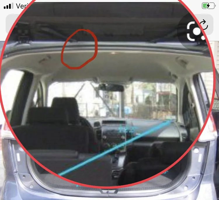

Check the grommet for the hatch door. Pull off (snaps) the plastic trim on the rear roof. Have someone drench the base of the grommet (outside) as you push and pull it (inside). If the car is old, the gasket around the grommet is likely getting dry/brittle. Opening and closing the hatch ay move it a little. movement/not perfect fit = water entry. Water comes in form there and and the plastic trim carries it off to the sides, down into trunk.
Current solution has been too live with it. After looking at having to take the door off to remove the interior panel I just have not been motivated. I can put in a new clutch, struts, and CV axles but not take off the hatch. What if wrong with me.
Not sure we are talking about the same thing. This is easy to check
