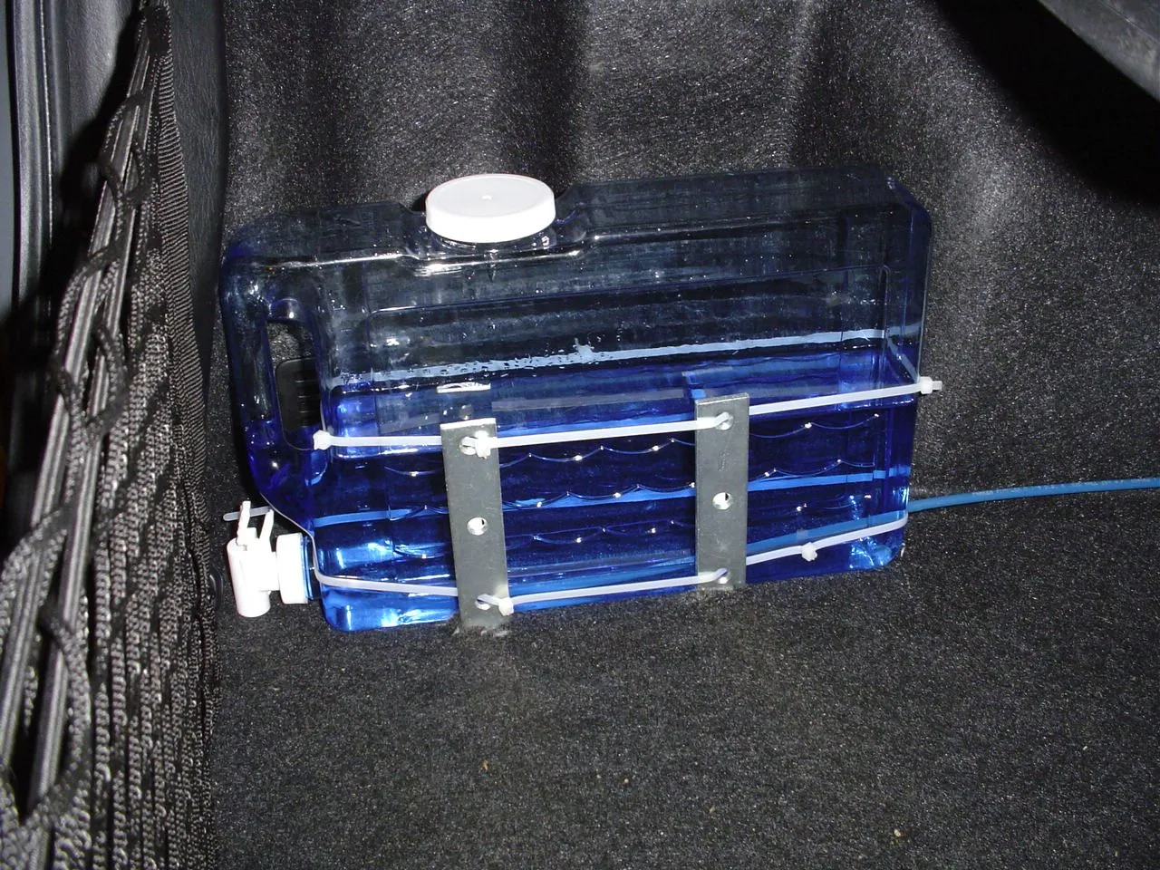

Here is a pic of the water tank in the trunk. Excuse the ghettoness, it should be prettier soon enough.
Just so you know, I sealed the spigot with epoxy.

its not that ghetto :)

I dont think it's very ghetto. I mean, there's not much you can do instead of zip ties in that situation. Only thing I could possibly think of to pretty it up some would be painting the metal brackets black. Don't take offense to that because I think it's good the way it is.
It's funny you should mention painting the brackets black- I had a set of brackets on there that I painted black, but they ended up being too short. I plan on painting these black too.
I am considering painting the whole thing black then leaving a small strip of unpainted section to view how much water is left. But, I'm not really going to worry about it too much- I very rarely have my trunk open.
