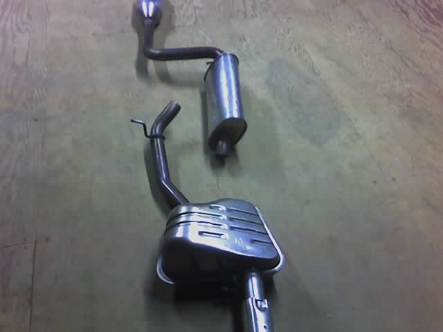

<div class="bbWrapper">06&#039;s gas tanks are in a little different position... <br /> <br /> Vibrant does fit, just gotta cut and weld a 3-4&quot; piece in so it will clear the gas tank without resting completely on the side... <br /> <br /> <br /> ARK said their exhaust will fit the 06s with no problems though. <br /> <br /> My clip of the vibrant<br /> <a href="http://media.putfile.com/Vibrant" target="_blank" class="link link--external" rel="nofollow ugc noopener">http://media.putfile.com/Vibrant</a></div>

<div class="bbWrapper">The exhaust did fit w\out welding, just made me a little nervous having something getting hot sitting up against a gas tank... <br /> <br /> You will have to cut the stock exhaust no matter what, as its one piece.<br /> <br /> Borla makes quality stuff, dunno how it fits on 06s though. I believe it deletes the second cat.... so it should be louder than most..</div>
<div class="bbWrapper">pretty sure borla is a cat back... its got a flange fitting for right after the stock cat.</div>
<div class="bbWrapper">If its got a flange then it deletes the cat, slip on retains it. It would have been nice to have a flange after the 2nd cat. Exhausts woulda been cheaper, and problems with clamps would be gone. <br /> <br /> <script class="js-extraPhrases" type="application/json"> { "lightbox_close": "Close", "lightbox_next": "Next", "lightbox_previous": "Previous", "lightbox_error": "The requested content cannot be loaded. Please try again later.", "lightbox_start_slideshow": "Start slideshow", "lightbox_stop_slideshow": "Stop slideshow", "lightbox_full_screen": "Full screen", "lightbox_thumbnails": "Thumbnails", "lightbox_download": "Download", "lightbox_share": "Share", "lightbox_zoom": "Zoom", "lightbox_new_window": "New window", "lightbox_toggle_sidebar": "Toggle sidebar" } </script> <div class="bbImageWrapper js-lbImage" title="05-16-06_1956.jpg" data-src="/forum/proxy.php?image=http%3A%2F%2Fimg.photobucket.com%2Falbums%2Fv310%2FNofriends%2F05-16-06_1956.jpg&amp;hash=fd4a881b085ddfe6bdf1899c7d3aa6a8" data-lb-sidebar-href="" data-lb-caption-extra-html="" data-single-image="1"> <img src="/forum/proxy.php?image=http%3A%2F%2Fimg.photobucket.com%2Falbums%2Fv310%2FNofriends%2F05-16-06_1956.jpg&amp;hash=fd4a881b085ddfe6bdf1899c7d3aa6a8" data-url="http://img.photobucket.com/albums/v310/Nofriends/05-16-06_1956.jpg" class="bbImage" data-zoom-target="1" style="" alt="05-16-06_1956.jpg" title="" width="" height="" loading="lazy" /> </div><br /> <div class="bbImageWrapper js-lbImage" title="05-16-06_1958.jpg" data-src="/forum/proxy.php?image=http%3A%2F%2Fimg.photobucket.com%2Falbums%2Fv310%2FNofriends%2F05-16-06_1958.jpg&amp;hash=0edb38eedc2f503398eed8cadabfc5ef" data-lb-sidebar-href="" data-lb-caption-extra-html="" data-single-image="1"> <img src="/forum/proxy.php?image=http%3A%2F%2Fimg.photobucket.com%2Falbums%2Fv310%2FNofriends%2F05-16-06_1958.jpg&amp;hash=0edb38eedc2f503398eed8cadabfc5ef" data-url="http://img.photobucket.com/albums/v310/Nofriends/05-16-06_1958.jpg" class="bbImage" data-zoom-target="1" style="" alt="05-16-06_1958.jpg" title="" width="" height="" loading="lazy" /> </div></div>
<div class="bbWrapper">wtf is that last thing? do we have 2 mufflers as well?<br /> <br /> <div class="bbImageWrapper js-lbImage" title="zwl0md.jpg" data-src="/forum/proxy.php?image=http%3A%2F%2Fi4.tinypic.com%2Fzwl0md.jpg&amp;hash=5ed5fb9c856817d8ba03c5c640227d8a" data-lb-sidebar-href="" data-lb-caption-extra-html="" data-single-image="1"> <img src="/forum/proxy.php?image=http%3A%2F%2Fi4.tinypic.com%2Fzwl0md.jpg&amp;hash=5ed5fb9c856817d8ba03c5c640227d8a" data-url="http://i4.tinypic.com/zwl0md.jpg" class="bbImage" data-zoom-target="1" style="" alt="zwl0md.jpg" title="" width="" height="" loading="lazy" /> </div></div>
<div class="bbWrapper">Thats the turbo whistler I installed.<br /> <br /> <br /> <br /> <br /> haha thats part of the Pzev emissions bulls***. That and if you look at the first pic, you can see my bung (3rd o2 sensor bung that is) right after the second cat. As the token black guy would say &quot;that s**** wack&quot;</div>
<div class="bbWrapper"><blockquote data-attributes="" data-quote="tsunami" data-source="" class="bbCodeBlock bbCodeBlock--expandable bbCodeBlock--quote js-expandWatch"> <div class="bbCodeBlock-title"> tsunami said: </div> <div class="bbCodeBlock-content"> <div class="bbCodeBlock-expandContent js-expandContent "> wtf is that last thing? do we have 2 mufflers as well? </div> <div class="bbCodeBlock-expandLink js-expandLink"><a role="button" tabindex="0">Click to expand...</a></div> </div> </blockquote><br /> We actually do have two mufflers. If you look at wetsuit&#039;s first picture, the second doo-dad after the flange is the first muffler (aka resonator).<br /> <br /> <blockquote data-attributes="" data-quote="WetsuitxNinja" data-source="" class="bbCodeBlock bbCodeBlock--expandable bbCodeBlock--quote js-expandWatch"> <div class="bbCodeBlock-title"> WetsuitxNinja said: </div> <div class="bbCodeBlock-content"> <div class="bbCodeBlock-expandContent js-expandContent "> If its got a flange then it deletes the cat... </div> <div class="bbCodeBlock-expandLink js-expandLink"><a role="button" tabindex="0">Click to expand...</a></div> </div> </blockquote><br /> Well... unless you get the Draxas or Vibrant with the replacement hi-flow cat. Then it&#039;s not deleted, only replaced. <img src="https://cdn.jsdelivr.net/joypixels/assets/8.0/png/unicode/64/1f600.png" class="smilie smilie--emoji" loading="lazy" width="64" height="64" alt=":D" title="Big grin :D" data-smilie="8"data-shortname=":D" /></div>

<div class="bbWrapper">so that wierd boxy thing is for pzev s***... wonder wtf it does? and GW the resonator is actually a muffler? i thought it was just a piece of steel welded over the actual exhaust pipe to give a different sound (deeper) then with out it.</div>
