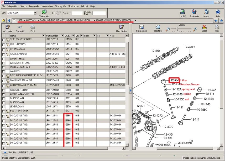

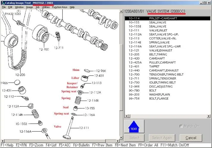

Where are you getting this information??
they DO NOT have shims, the "shim" is integrated with the lifter/bucket
look in the service highlights manual and it explains it clearly... it says "shimless" all over the place.... in fact, it's on page 01-10-23 on the 2004 mazda3 service highlights manual
also the parts catalog shows it clearly that there's a lifter but NOT a shim... but if you look in detail, there's 37 different lifter part numbers
like I said.... valve lash adjustment on the LF and L3 engines *require* camshaft removal which is not only time consuming/labor intensive, but expensive
valve lash adjustment on the older mazda engines such as the FS does NOT require camshaft removal... a SST from mazda or a "toyota" shim adjustment tool (such as one from snap on) is all that's needed to quickly perform the proceedure
I just looked on the 2006 FSM... it says "select proper adjustment shim" on step 15... it's wrong, although the calculation for a thicker "shim" (lifter in this case) is correct
here's what it shows in the parts catalog to remove any questions as to which book is correct
here's the FS-DE one to compare so you can see that there *is* an actual shim compared to the L3-VE one

Weird. So what's the price difference between the FS-DE shim and the LF/L3 "adjusting disc"?
