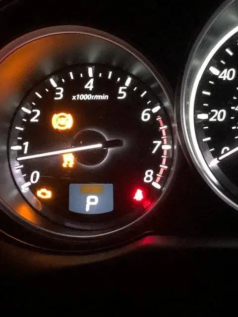

You can go ahead and blast me after the fact. I have a 2016 CX-5 AWD that needed struts. I bought KYB for the model and paid a mechanic I know to install them. He did yesterday. Today, I drove to and back from work -- about 80 miles round trip -- and the car handled fine the whole time. About a mile from home, after a stop, suddenly every warning light came on, and a few seconds later, a very faint intermittent scraping sound from the front end. I limped home. Parked in the driveway, let it sit a minute and restarted it. The check engine light,ABS and (I think) AWD lights are on.
I left a message for the guy who did it, but I'm going to need this fixed tomorrow. The more expensive shop I was trying to avoid seeing is about a mile away. Any idea what happened, how to fix, and if I can drive the car safely the mile to the shop?

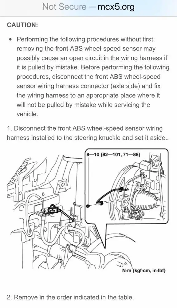

research online shows the ABS sensors are hooked into the struts on some Mazdas. I am suspecting that is the issue.
Here are the lights on, after restarting:
80 miles IMO is just about enough to significantly loosen up a bolt that wasn't torqued properly. And a major ABS fault, due to parts moving around, could certainly trigger the CEL as well. Strut replacement includes disassembly/reassembly of a significant amount of the suspension/steering/brake components, and any one of them being ready to detach could literally be fatal. There is no way I'd drive this vehicle without first having someone who is competent taking a close look at what's going on. Your safety (and anyone who is on the road with you) is more important than anything you need the vehicle for.

breaks work fine. I drove very slowly and took care around corners especially. Some research online shows the ABS line/sensor is tied to the struts in the front. Except for the lights and the slight metal-on-metal sound, the car handled the same as ever, but all the lights came on and there was the noise. I suspect the line/sensor has been damaged, but will take any opinions.

I still believe the culprit should be, like MyFirstMazda’s guess in post #11, somehow one of the front ABS wheel-speed sensor wiring connectors didn’t plug in properly.
