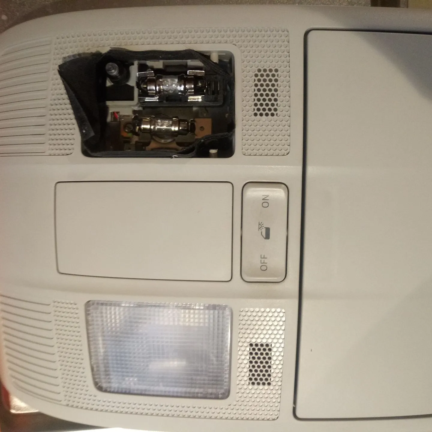

I am working on a mod for red LED on one map light. I used a small low lumen 30 degree LED in the right side. It works great for just enough light to see without disturbing outside vision but because the LED is positioned in the left side of the housing there is a sharp cutoff and doesn't illuminate the driver side area very well.
I might add a festoon for a 2nd bulb in the housing or maybe switch the red to the other side.
The 3000K LED in the other map light is brighter than both of the old bulbs together and it has 150 degree dispersion.

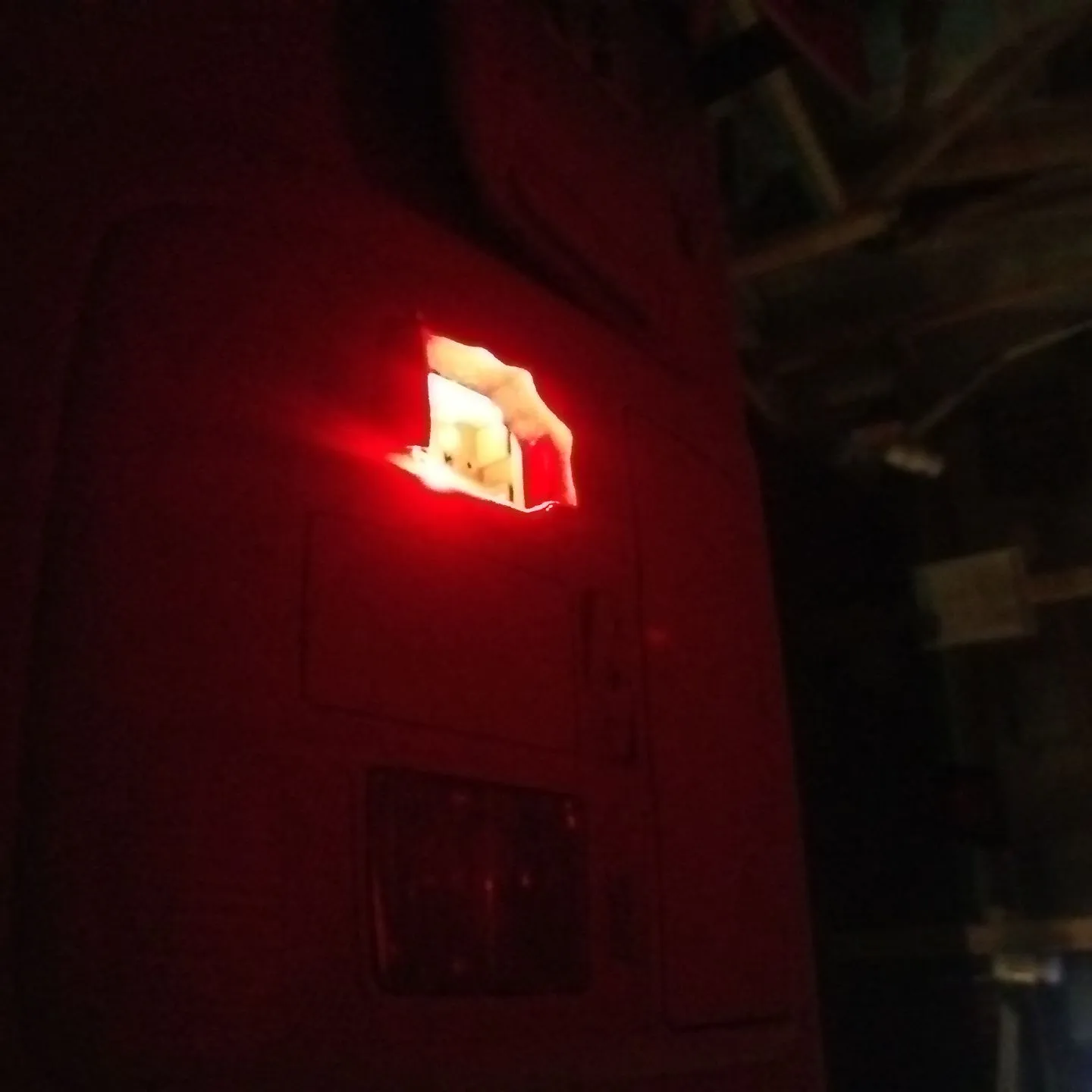

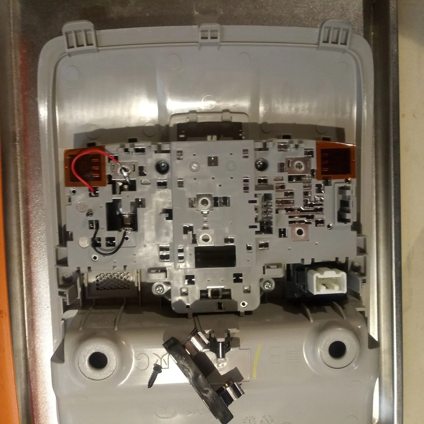

I just added a second red LED to the right side map light.
I had to shorten the festoon bulb holder about 1/4 inch. I attached two wires and soldered them to the existing bulb holder.
I attached the bulb holder to the map light with a small screw.
towards the driver seat. Because the bulb is on the far side and slightly lower than the other bulb it is able to project clear over to the driver side door. It lights up the window control which is what I wanted.

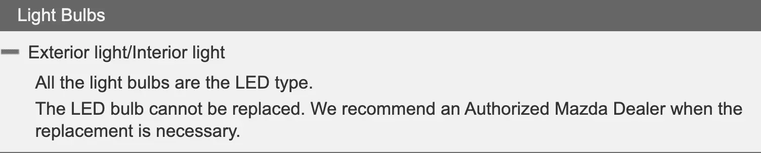

The newer Mazdas have LED interior lighting standard. My understanding is that they’re not “replaceable.”
I knew that the Sig came with LEDs, but did not realize that they are sealed units. (The 2019 Reserves do not, and with Mazda stripping out options (like standard NAV), I doubt the 2020 Reserves do.)
That's rather odd. But I guess if they don't fail under warranty ("infant mortality") they'll be good for a very long time.
It still strikes me as odd.
I recently test drove a CX-30, and drove a 2020 Mazda3 loaner. These models represent the design direction of all new Mazdas. The dome/reading and vanity mirror lights on both of those models look to be one piece, with no visible seam to pry it open for servicing the “bulb.” Replacement probably involves replacing the entire light housing. This image is from a CX-30 manual.
Huh. Interesting.
Not sure I view it as progress, but I'm an old school guy. I'd ezpecially worry about the exterior stuff, which is exposed to all sorts of harsh conditions.
I can see the state inspection experience. If a turn signal or brake light is out, you can no longer have them put in a new bulb and slap your new sticker on...you gotta go to the dealer.
I wonder if other manufacturers are moving (have moved?) in this direction.
