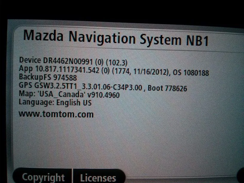

There is a new map just released Version 9.10 available.
There is a new map just released Version 9.05 available.
I'm in the USA too, and Mine is newer. 9.10 been like that for several months.
attachment.php
