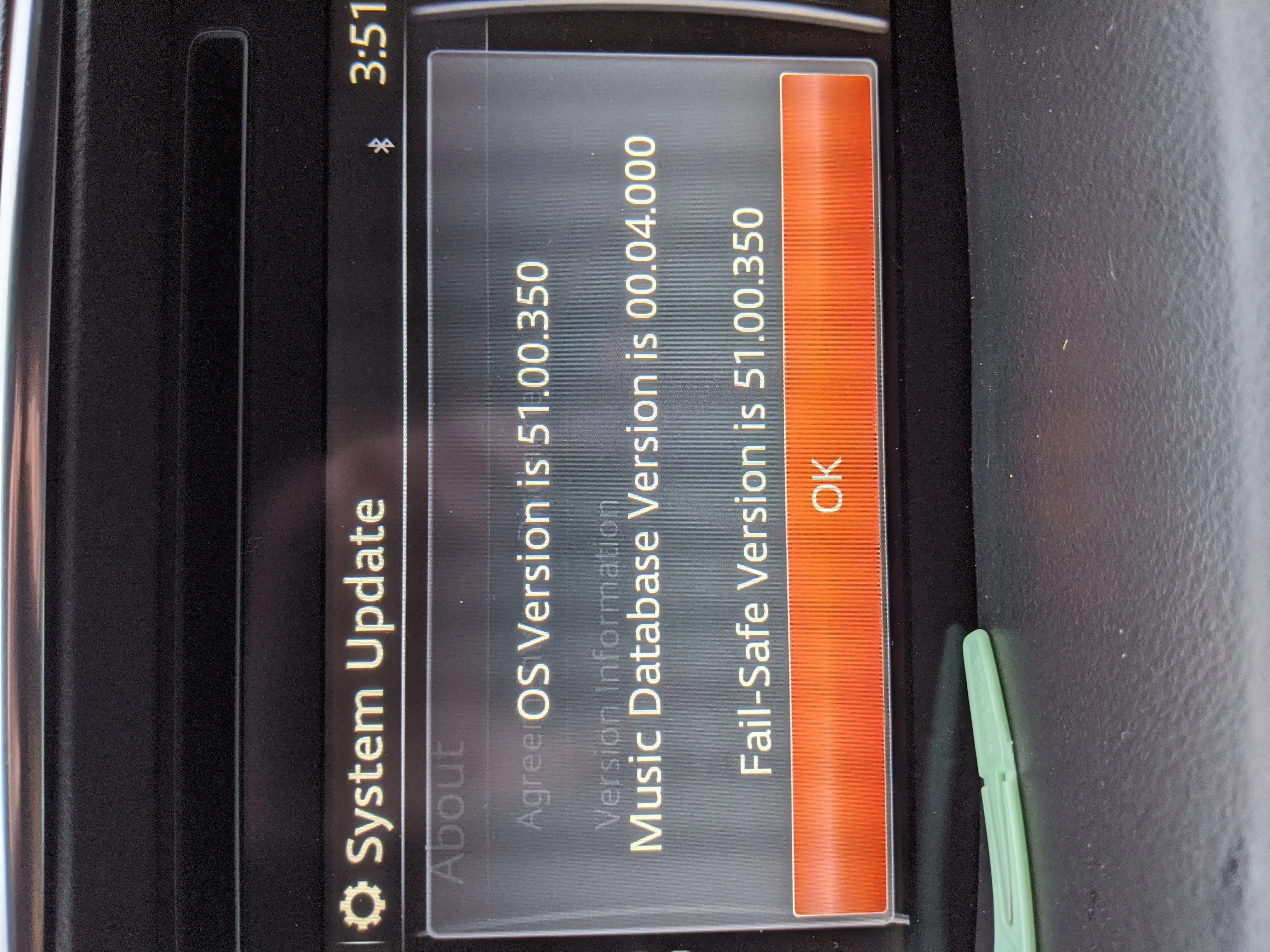

Will this work on on my 2016 CX-5? My version seems much older than you folks are discussing. I've attached a pic.
Will this work on on my 2016 CX-5? My version seems much older than you folks are discussing. I've attached a pic.View attachment 222441
It will work but the procedure is slightly different. Follow the instructions exactly as listed and you cannot go wrong. BTW, I pumped the breaks every 5 minutes instead of the 20 minutes recommended. Did not want to take any chances on the system timing out.
Before doing anything read the instructions in detail. Do a dry rehearsal run to avoid surprises.
If you have ANY doubts, tell the dealer you are having some issues and have them do the update.
