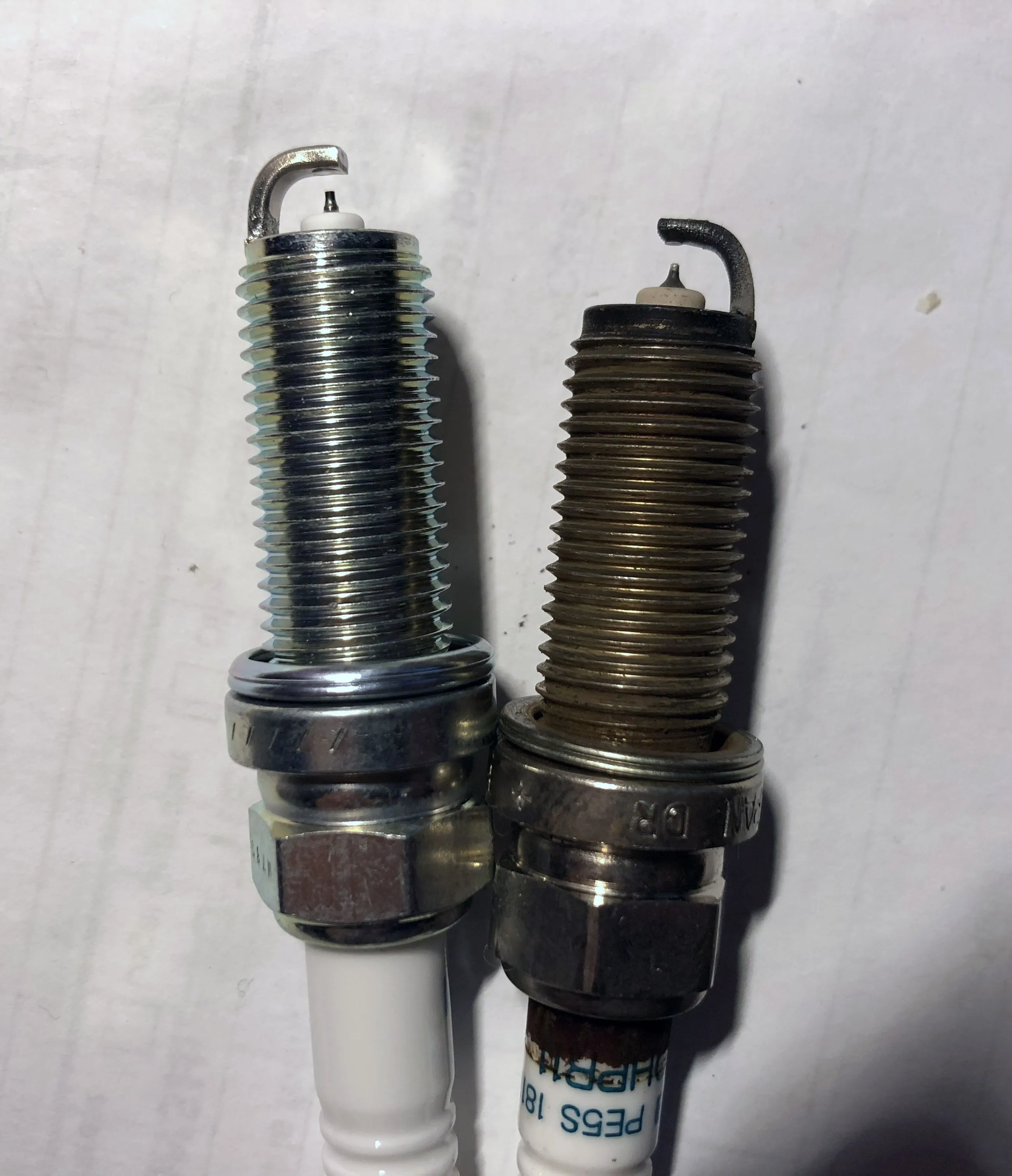

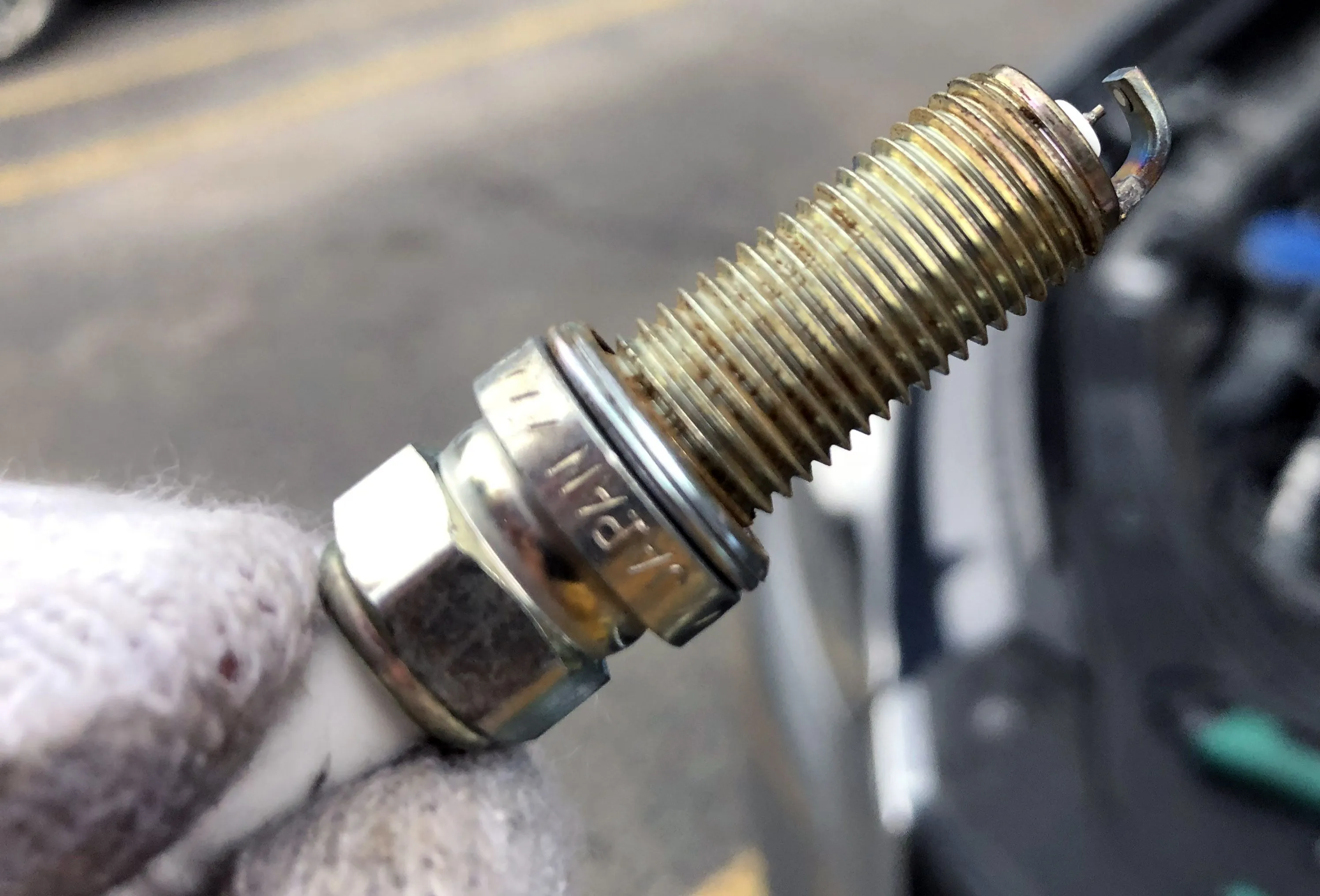

UPDATE: Thank you all for replying me! I have all the new spark plugs installed anyway, and I will probably start a new thread to discuss about the performance of these new plugs. Here is a photo that shows what a spark plug looks like after one day of usage:
Below are original post:

To my suprise, the old spark plug seems to be just fine, much better than I anticipated. How could a spark plug that has 73000 miles on it be in such a good condition! Of course, I failed to find any obvious flaws, but it's probably because I can't tell the real problems. So I took a photo of it comparing to a new one.
Do you think this replacement is totally unnecessary?
By the way, my OEM spark plugs are 'Mazda PE5S 18110"
What were you expecting a worn out spark plug looks like? Looks pretty old, dirty, to me. I mean, your engine wasn't throwing codes, which you don't want it to, so yes its still going to physically work, but the point of maintenance like this is to prevent problems before they happen. Don't overthink it, you did the right thing. :)
Old plug looks to be of a higher quality than the new one. Maybe we are just seeing difference between two different makers? NGK vs ND?
The iridium pad on the new plugs ground electrode looks odd (thin and ground down), as well as the weld job on the ground electrode.
The bar stock used to form the ground electrode on the new plug looks very "square".
The center electrode on the old plug has a nice taper to it where it meets the shoulder of the ceramic insulator. New plug does not.
The hex shell where the tool fits is also different between the two plugs.

So the old plug is on the right? Or did these both come out of your car? Because the one on the right needs replaced, no question.
attachment.php
Thanks to your side-by-side comparison picture beteeen NGK ILKAR7L11 and factory Mazda PE5S-18-110 spark plugs. In fact this's the first time I saw such comparison picture. Why there's no any model imprint on ceramic insulator of NGK plug? I agree with mazdadude they look physically different which makes me believe NGK and OEM plugs can't be the same like some people claimed. I now definitely would use OEM PE5R-18-110 plugs although they cost a lot more than NGK's.
