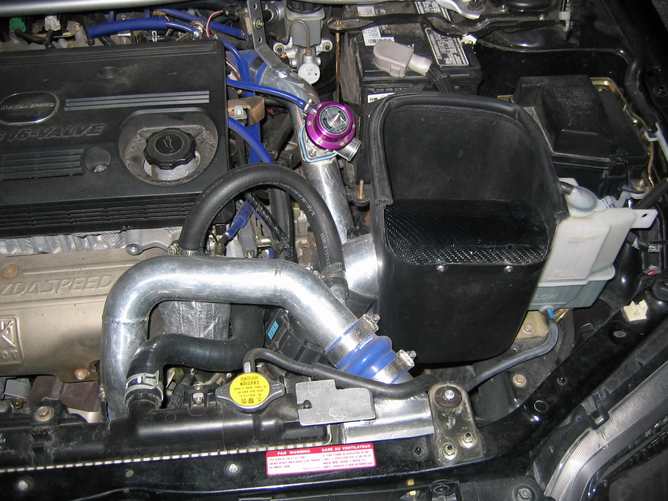

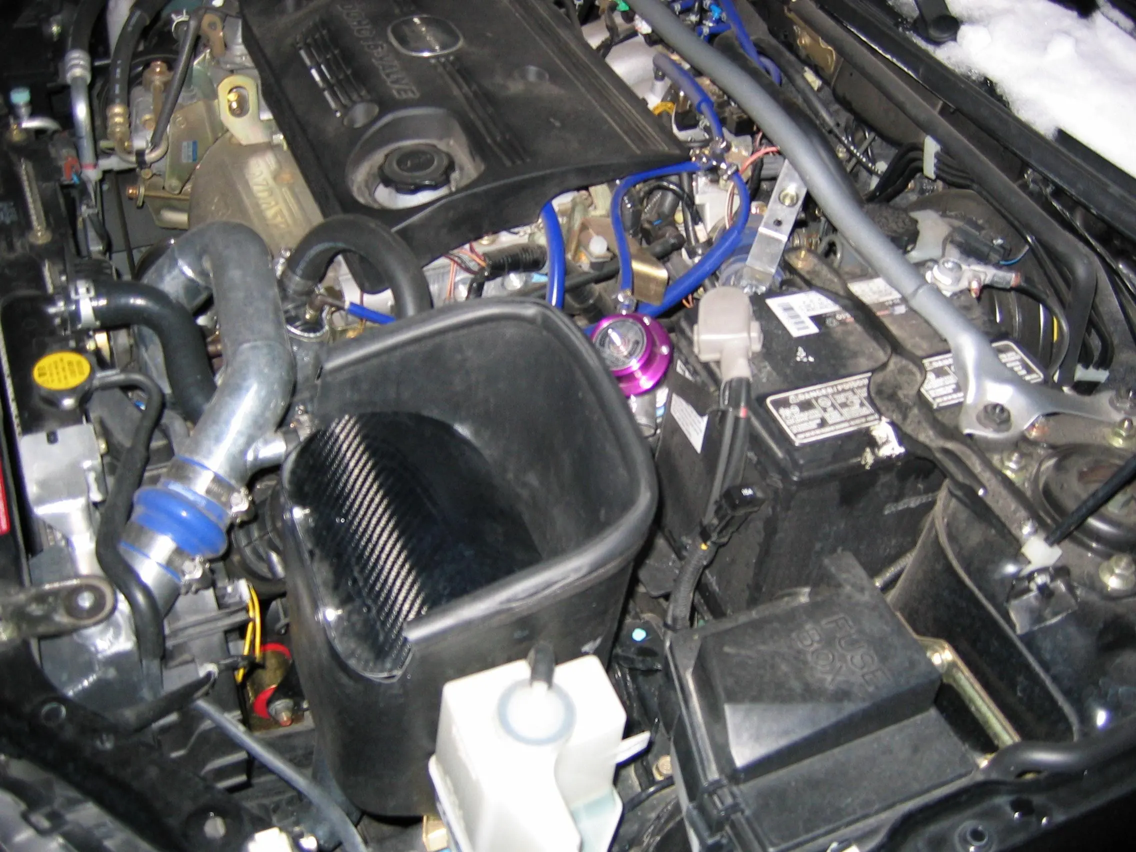

sup, i know u have dg ram air hood. from the pix 505zoom posted u think the air filter box thingy that comes with the hood will fit ?
I'll let you decide. I'm going to say probably not. Here are some pics I just took. Sorry for the dirty engine bay (winter time).

wicked said:
looks good.can you shed some light on a few things for me and others?
1)any problems with rubbing on the fender hole?(mines routed about the same,and it was an issue for me.)
2)did you support the IC to TB pipe anywhere?
3)bracket for solinoid by throttle,I can't see if you put one or not.
4)did you give up on the clocking the turbo?
5)I don't see a BOV,or BPV
6)when you do the intake,is it going to be high enough to avoid water?
7)are the MAF,and IAT wires going to need to be extended?
8)why did you not run the MAF on the presure side?(I moved mine about 8 months ago,better throttle response,and more accurate reading,
when I did it I thought turbulance would be an issue,but the factory difuser works well.
9)what DIA filter are you going to run with?(I used a 4" filter) turbo to 45 deg 3"transition silicone,to 3" to 4" metaltransition90deg down w/ filter. wanted to keed it as short as posible.
1) No.
2) No, no need with the straight coupler up at the TB.
3) No, it will look better to relocate it.
4) For the most part.
5) You won't be able to see either one even if you do the BOV/BPV setup. Looks cleaner that way. BOV is down low on the turbo--->IC pipe.
6) Yes, by a long shot... best looking intake design I have seen for us by far.
7) No.
8) The MAF was not designed for that. That's great that it works for you, but Beau can't have the risk of people ruining their MAF because of his kit.
9) Pipe diameter is 2.5", and the filter will attach to that.
If you need any further clarification on any of this, please let me know.
