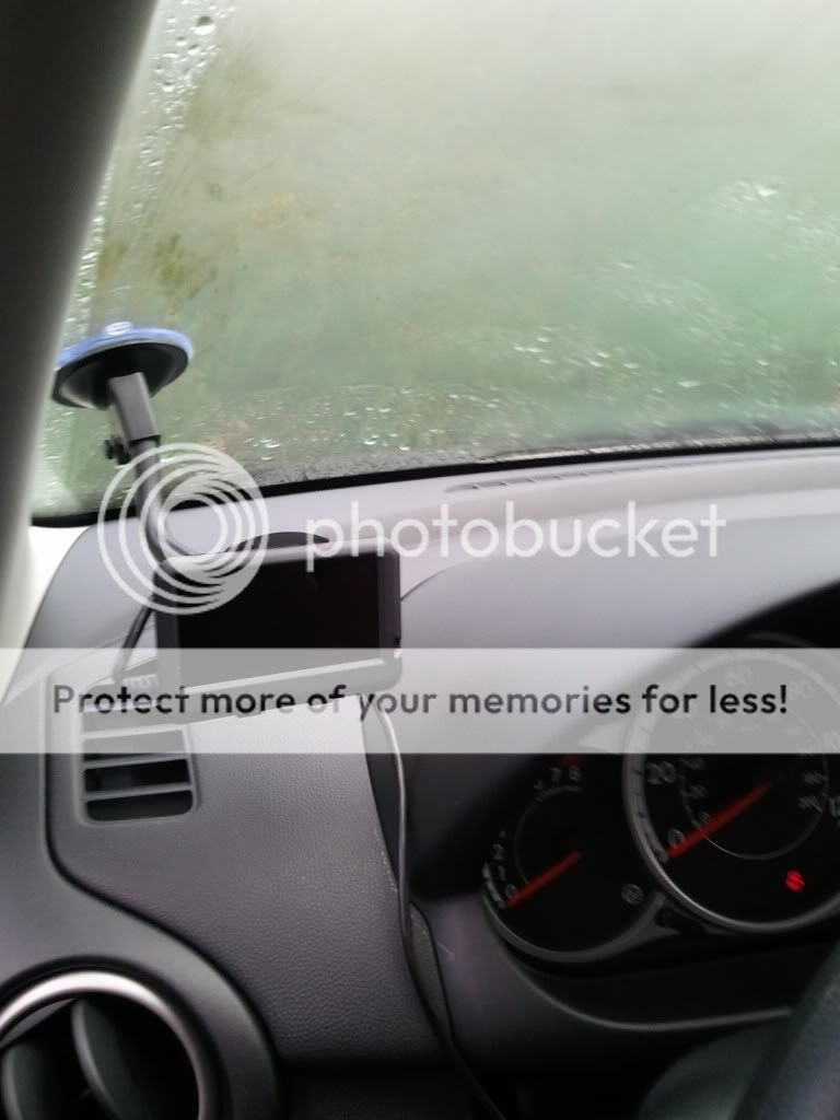

Install it with the arm last night.
I love it, it's not pretty but it's very very useful.
The arm is awesome! it's super long which is nice since the M2 front window slope is so steep.

Just ordered one last night. I live in Vancouver, B.C. and the shipping charges to here were $23.xx. So, instead I shipped it to Blaine, Washington (35 minute drive at non-peak time) for $8.21. Should be here early next week and I'll hopefully run down for the day on Wednesday and grab it (my day off and gf working). Looking forward to finding an interesting spot to mount it and trying it out. Thinking I may even try mounting it near my accident recorder video camera I have hard-wired.
Went to install into my wife's car tonight and noticed the attachment arm is different than in redkills post. Its a long, straight arm, and only the angle of the guage can be adjusted, not the angle of the arm. So its useless. I'm not happy. I suppose I'll be sending them an e-mail.
edit: After some searching on their site and checking the mount again, I found the entire arm peice is flexible. It just feels like solid plastic and I didn't try with enough force to bend it.
