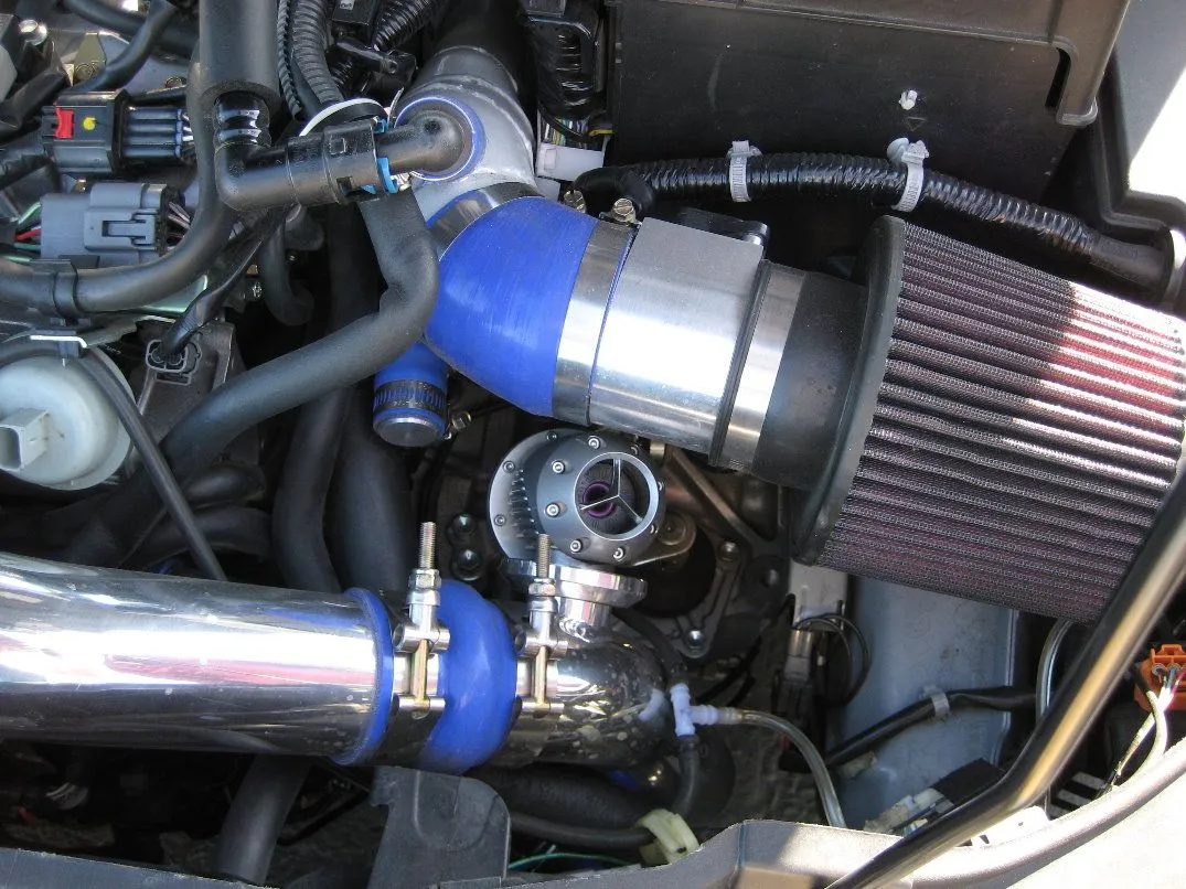

What great about the MSCAI is the breather tube is still able to be used .....the ATP elbow doesent have that option, so you have to use that top 90*hard plastic elbow from the top part of the inlet i see you just have it caped off....

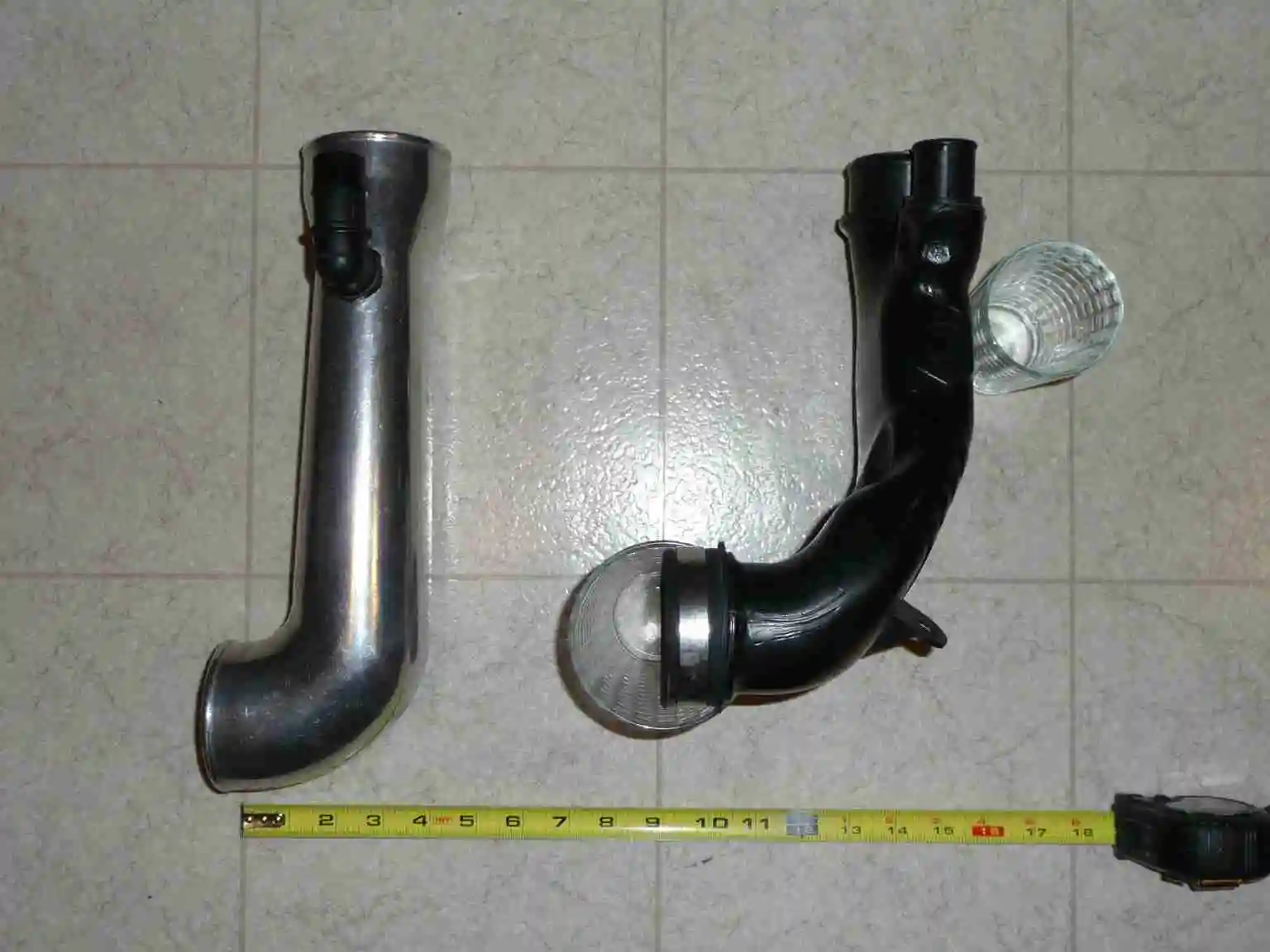

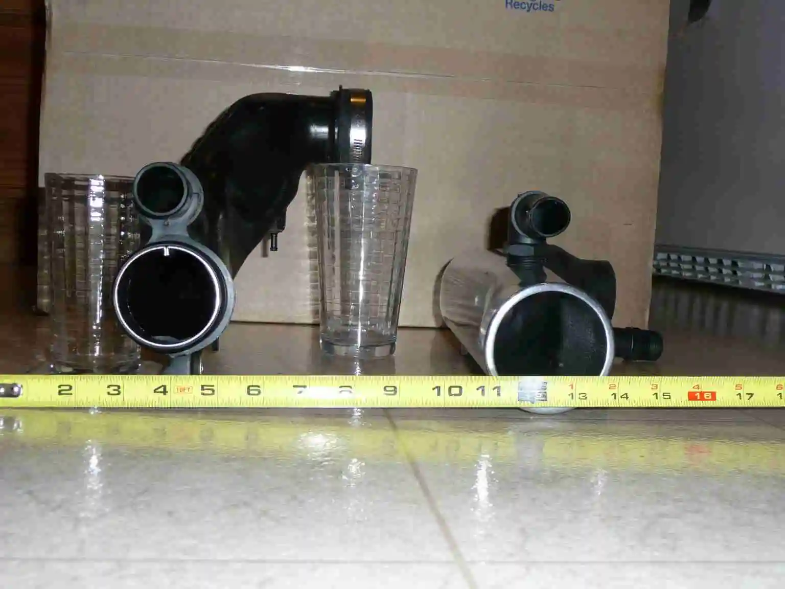

Do you have any pics comparing the stock piece to the ATP piece?
Try and ignore the glasses! I wanted to prop them up at the same angles.

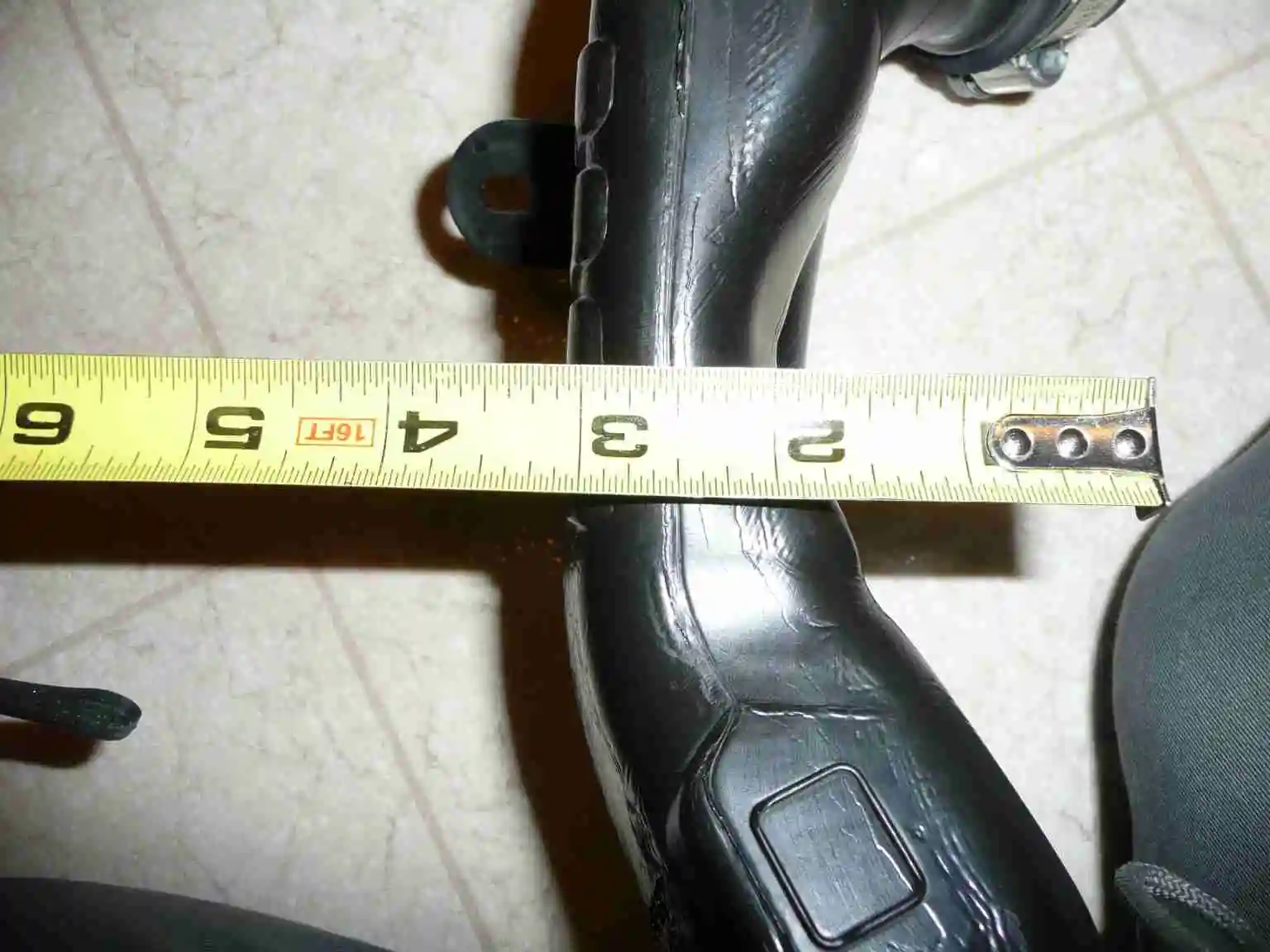

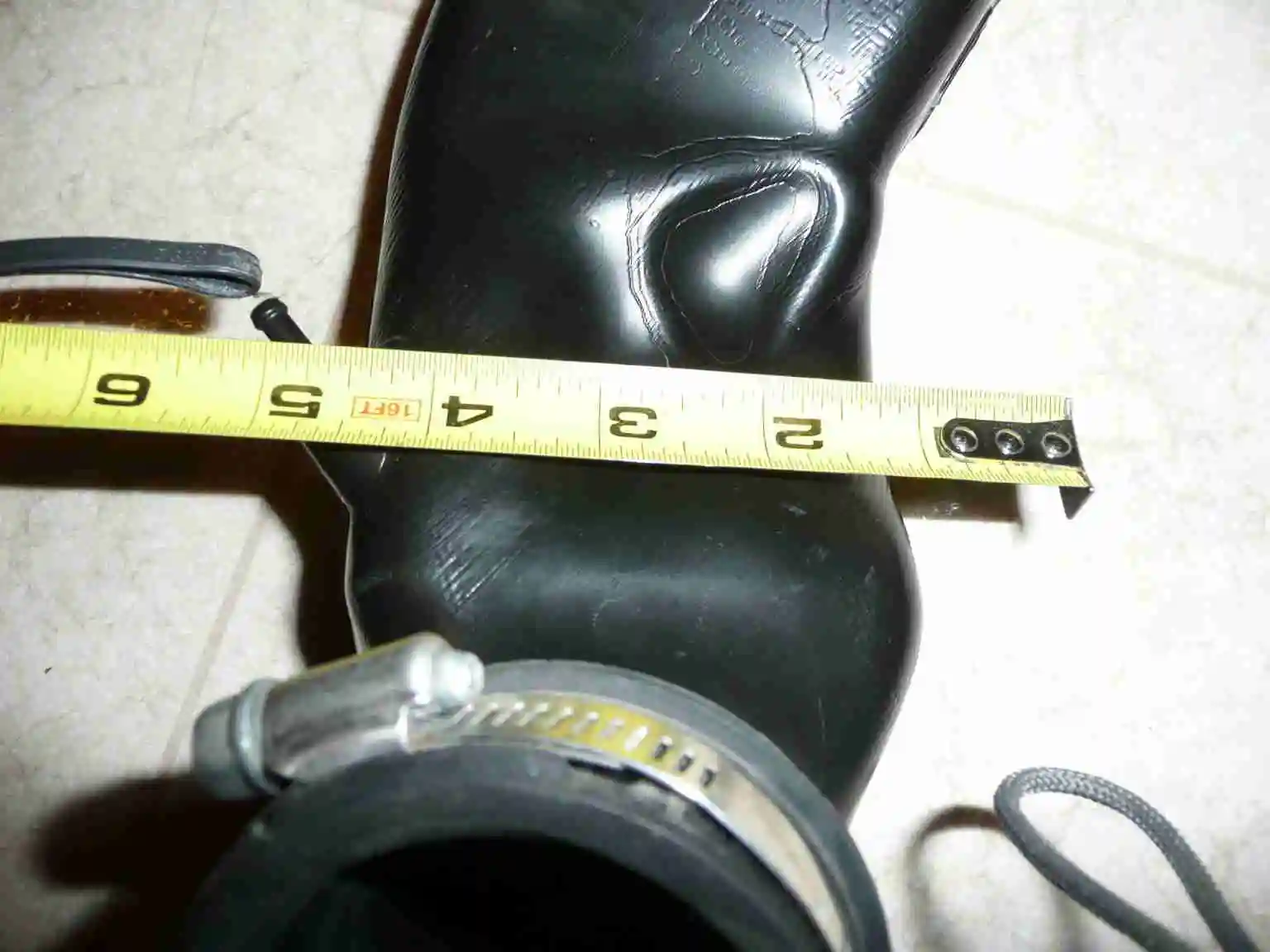

Also, look at the restriction in the stock inlet right before the turbo..
