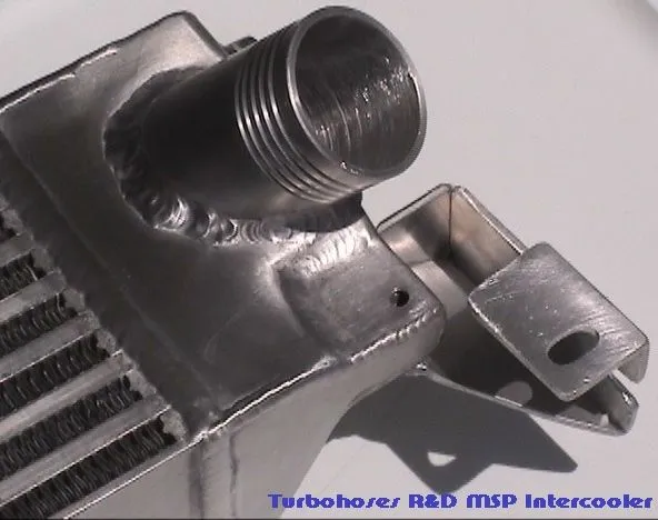

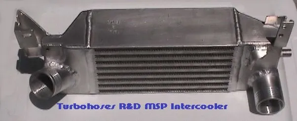

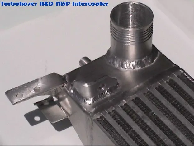

Long awaited Intercooler that shows gains is finally here.
Orders now being taken for the SMIC. It is a limited production unit. The first production run will be 5 SMIC. First 5 orders paid for will secure a spot on the first run. Once the 5 spots are filled, 5 more spots will open up for production run #2 and so forth.
SMIC will ship out in 2 weeks.
SMIC
$595 + shipping ($15ish).
SMIC & Piping Kit
$975 & Free Shipping
TurboHoses Aluminum Hardpiping kits also availible with and without aftermarket BOV. Hardpipes availible
Please post questions regarding the SMIC.
All orders must be called in. Thank you.
TEST RESULTS:
Our test vehicle is completely stock and tested with Turbohoses Aluminum Piping and stock boost.
The end results are as follows:
Baseline:
1.Turbohoses IC= 158.3hp/169.1ft. lbs tq.
OEM IC= 142.7/159 ft. lbs. tq.
2. Turbohoses IC= 157hp/167.1 ft. lbs. tq.
OEM IC= 142.4/158.1 ft.lbs. tq.
-Break 2 minutes before next run on Turbohoses IC-
3. Turbohoses IC= 158.5hp/169.1 ft. lbs. tq
-Break 5 minutes before running OEM IC-
OEM IC= 140.7hp/ 152.9 ft. lbs. tq.
4. Turbohoses IC= 154.6hp/162.4 ft. lbs. tq.
OEM IC= 138.7hp/150.2ft. lbs. tq.
Note:
Turbohoses Ambient Air temp.= 87 deg.
OEM Ambient Air temp.= 83.5 deg.
Dynoing with the OEM IC resulted in hesitation on WOT.
OEM Intercooler Pipes: Unable to complete dyno run due to engine hesitation at WOT.
We also took a temperature reading comparing aluminum vs. steel piping using the stock IC.
Aluminum- 100-108dg. f.
Steel- 135-142 dg.f.
