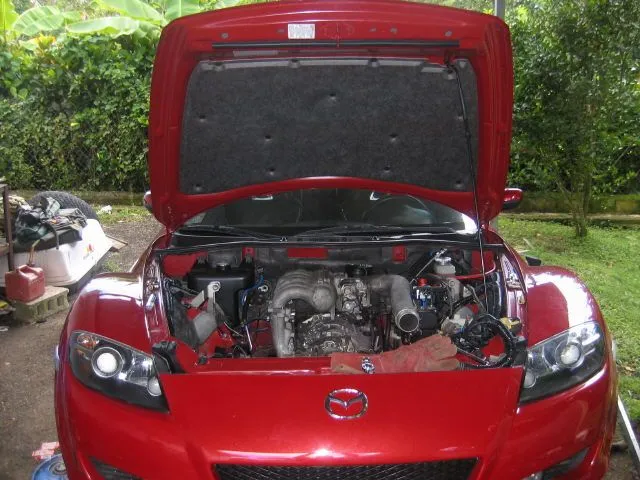

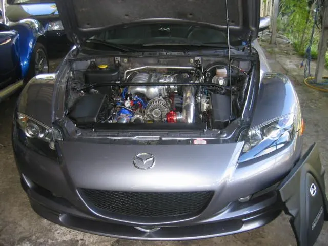

we using the RX8 6 speed tranny on it with a few modification , custom input shaft, hardened secong gear and crown, counter shaft. the rx8 6 speed tranny is durable with the exeption of 2 gear. all depents of the drivers shifts skills. This car is daily street driven an runs on pump gas everyday to work the acosta racing is more for show and i cant forget that's very impressive too. (cheers)

Maybe is a horse. (deadhorse
The Other one

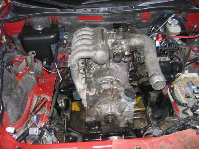

there's the other convertion to 3 rotor (thumb)
