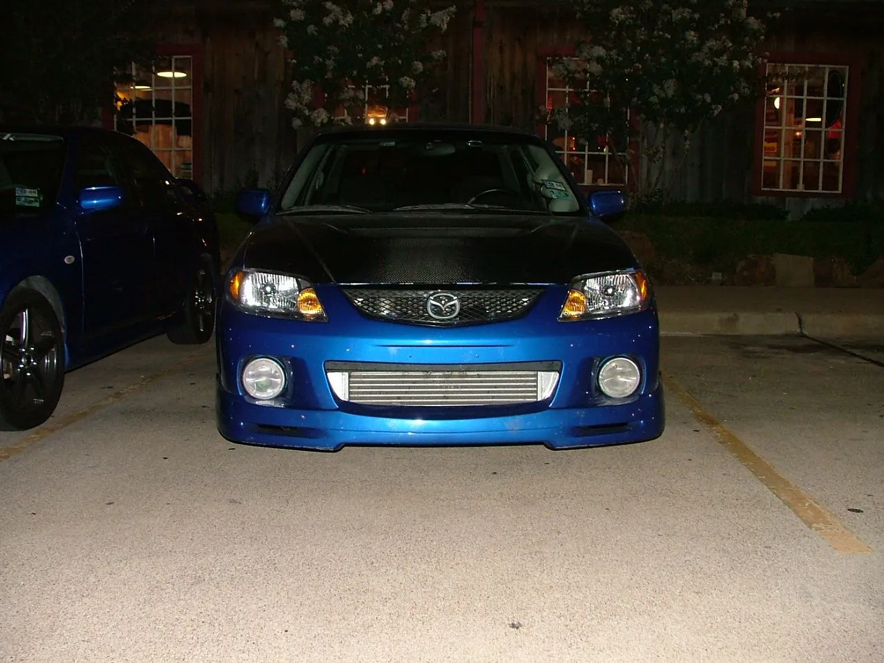

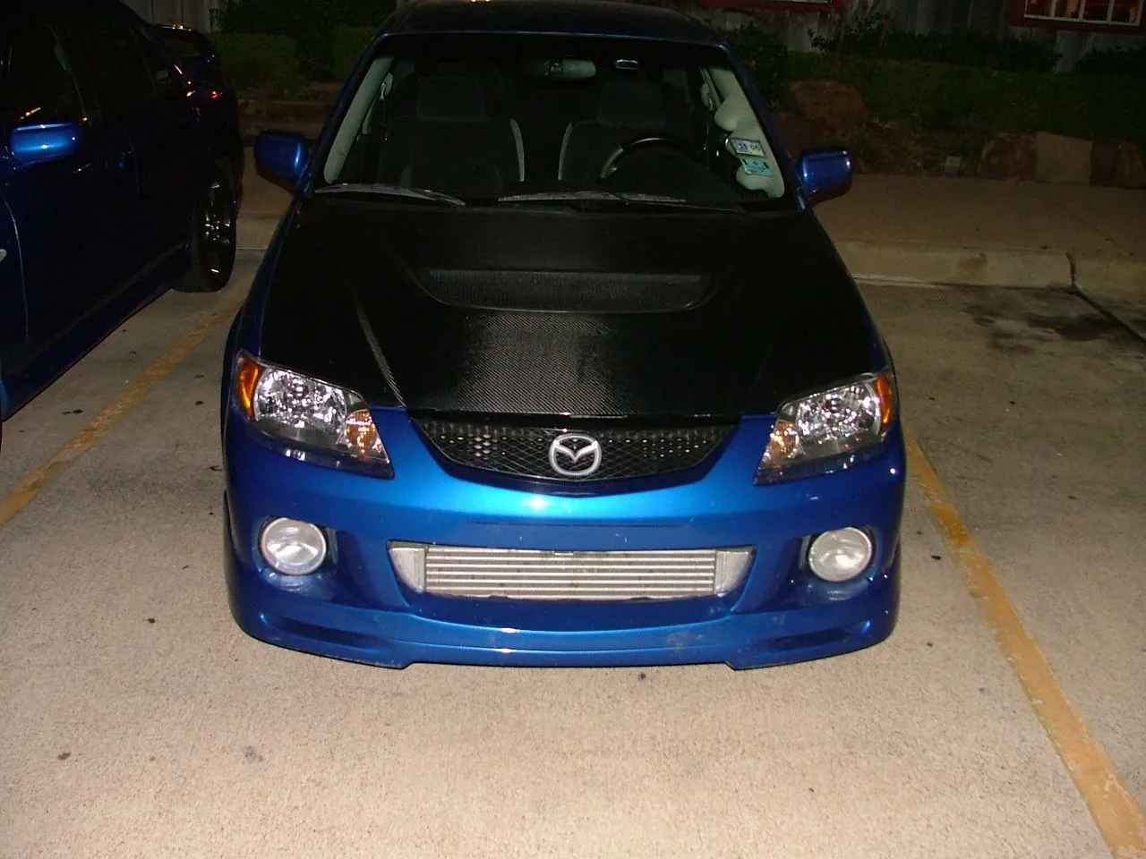

Front shot..
First pics of my car since everything was restored. Needs a wash!!
Fact: you know that there is something fishy about an MP3 when it has a huge fmic and the msp still has the stock smic. LOL
Honestly, great job on the turbo upgrade!
