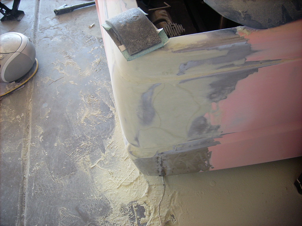

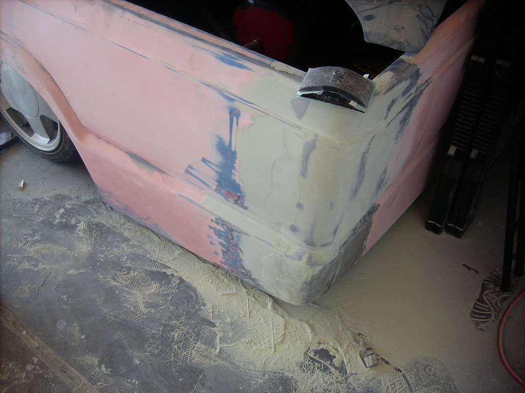

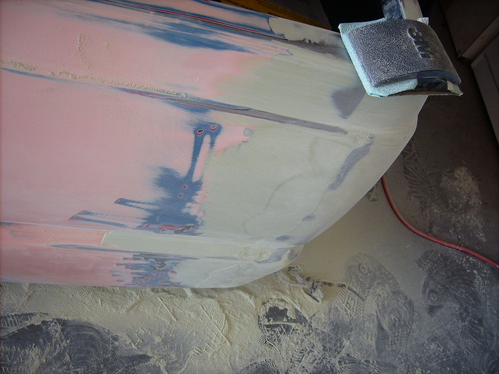

alright, heres a little gay update since its been awhile since i posted pics.
mind u i still have a lot of work to do on these and they are nowhere near perfect..
used evercoat body filler if anyone wanted to know. just make sure u are applying filler to bare etched metal or to existing filler...

Grind, Grind, Grind, Fill, Fill, Fill, Sand, Sand, Sand.
Repeat
-Derrick

cool man. thanks for the info. i really had no idea what brand to get or what was good or not.
much appreciated!
Mazda uses the 3m stuff when they assemble the cars for the sheet metal seams.
I used the stuff when I put a new core support in my 323 after doing the welding.

good to know..
what did u use to apply it with? a brush or did u just use ur finger?
There are two ways to do it. #1 is to buy the overprices applicator squirt gun or #2 mix it and wear vinyl glove and got he finger route.
I did the second method.
