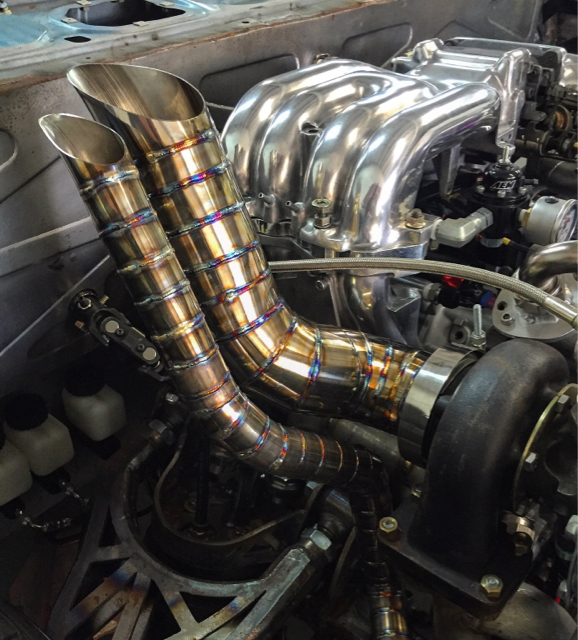

LOL! I tried shining up bits on my car and my wife's coupe and... it was definitely a lot of work. Well worth the effort in your case because your engine looks sharp.

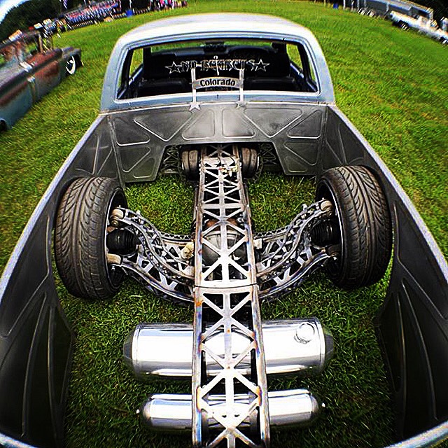

I can almost shave using those as mirrors. Are you going to leave the steel raw, clear coat, powder coat, paint?
mymmeryloss
13bT Mazda B2600i
The frame will get all of the sanding marks and imperfections cleaned out of it leaving the tig welds visible and then get clear powder coated with a pearl top coat.
