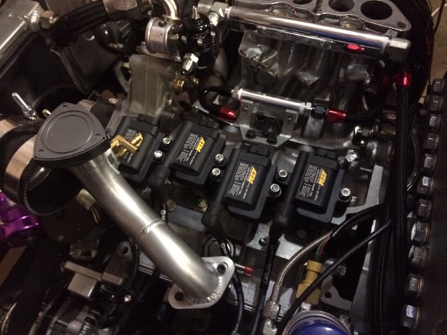

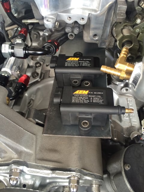

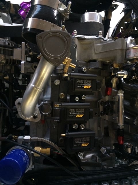

Do you have a close up how the coils are mounted to the top of the engine?
I dont. Not off the top of my head.

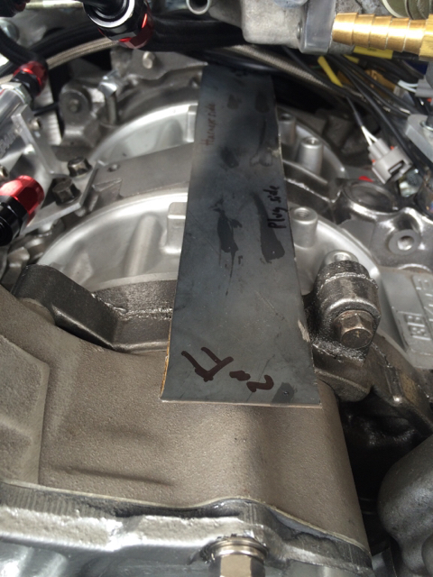

Pretty simple bracket i made that i will remake now that i know that they will fit under there. It was a super tight fit, but you dont have that problem!
Found some for you lol.
Basically just offset them on a flat piece of 1/8" steel and drilled holes for all thread then welded it on the backside then cut out a pattern in it. Will eventually have one cut out on the plasma table though.

Thanks! My intake manifold and throttle body sit closer to the block than the stock setup so I'll have to take a look to see if I can try something like that. I don't like my current setup with the coils behind the driver's headlight. I also have a coil-on-plug setup for these coils that would be super-compact but installing everything requires modification to the coil body, which I'm hesitant to do.
I bet you can come up with something
