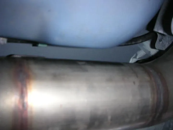

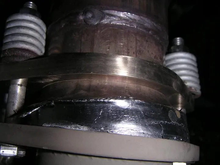

The DP mates to the cat pipe via this ball joint sytle connection. There is a rounded gasket that goes on the DP and the cat pipe is flared at the end to go over the gasket and use the springs from the old exhaust in the application so the pipes can move. My flare on the cat pipe was not flared enough and just basically butts up against the gasket.
The same cat-pipe for some reason had an anle to it making it point up and smash my cross memeber causing sever rattling.
These problems I had fixed for 90 dollars at a great shop here in NJ so no biggie.

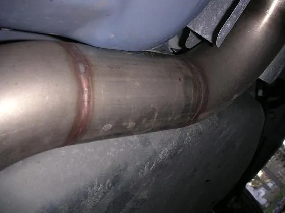

here are pictures of the gasket butting up problem I was talking about. And also here is where the exhaust was hitting in the back of the car prior to being fixed and then a pic after fixed.

Goodluck on the install! Too bad I'm so far away, I even have the weekend off

man thank doesn't look good!!!! I hope it works well and I hope mine doesn't have any issues...
