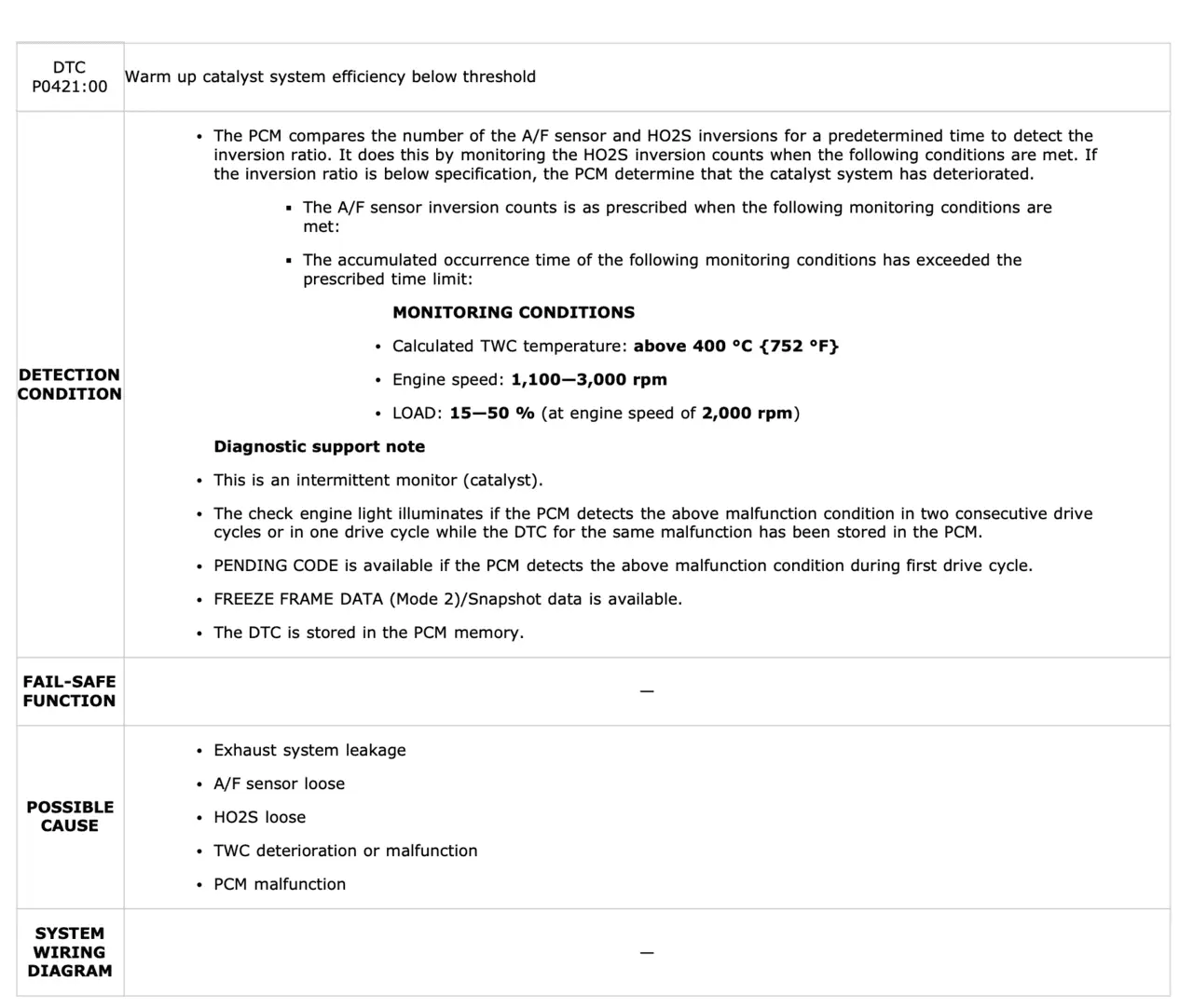

Or it took out O2 sensor
Or it took out O2 sensor ...
Yes, that's possible as well, and I actually did replace the far less expensive O2s for a cat code in the past myself. My try was unsuccessful, as are most of them, but doing so is no big expense for a DIYer. However, I suspect that most shops wouldn't take that approach, unless the owner requests, and pays for it.
