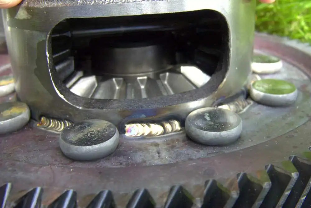

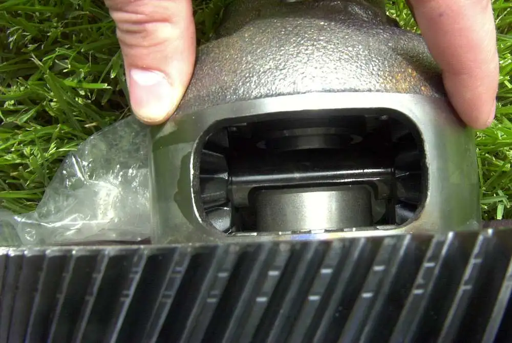

here are the pics though for you! I included one of the stock open diff so you can see the differences there too.
edit: the welds you see along the edge were something I had done... not normally there!

I'm not super familiar with the "positrac" idea... I'm more use to the gear, viscous, clutch, and derivatives of them LSD's... the little bit of poking around I just did said that positrac is really locking the wheels together for the most part.. not actually being an LSD, and that it is often noticed during tight corners in parking lots etc... well I that isn't anything like the way the LSD I have behaves... so I don't know! they are obviously different... but how one works versus the other is definitely debatable!
The fact is it resembles an open differential. How it works the closest explanation was the posi trac thing. I only know of helical gear and clutch pack lsds. I wonder how the revised springless lsd exerts pressure to lock up the spider gears? Maybe the revised is a wannabe phantom grip?
