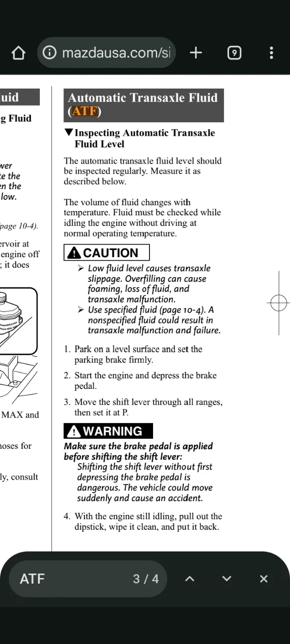

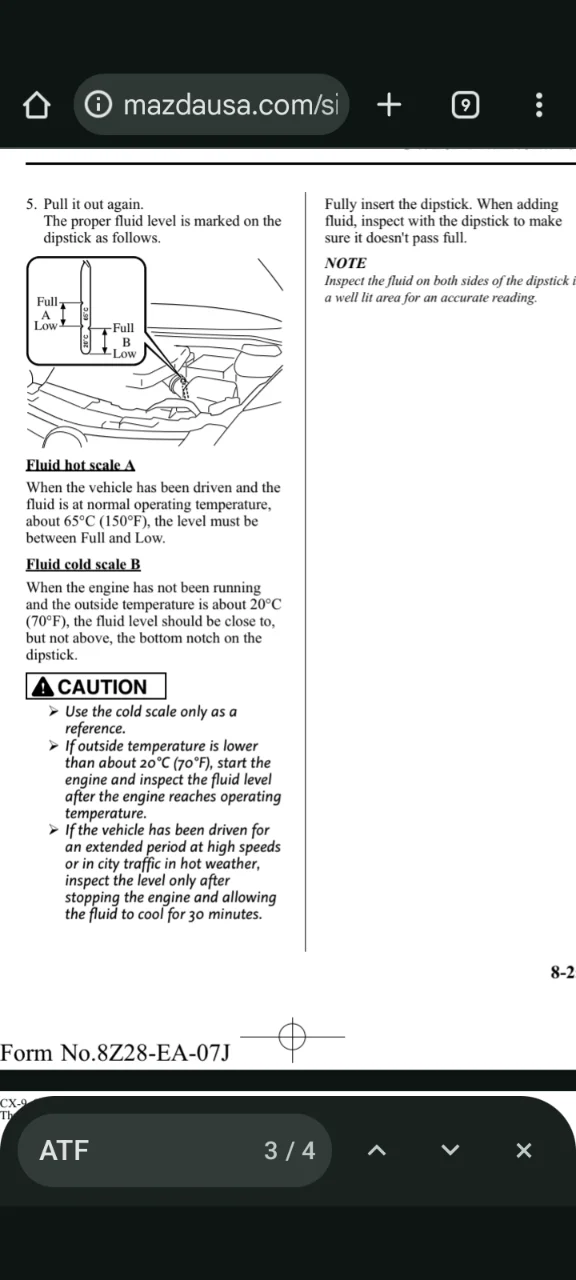

Checking the fluid level has been a little tricky. For me. Not sure if I'm doing something wrong. After cleaning and re inserting the dip stick. The measurement seem low one side but the other side it reads high. Very mis leading and not sure if it to hot or if I should turn of the engine. I know with transmissions you should put it idiling so I'm just confused with this one. So dont add any Lucas translip or the other stuff you mentioned earlier?
Are you able to read the ATF temp when you check the level? Car should be running and temp is at 122F in order for the reading on the dipstick to be valid. Some folks use a infrared-thermal device, others (me) use OBDII reader/app.
I dont have the Skyactive transmission. I have 08 6 speed cx-9. The procedure is not working for me
I am inclined to believe that you can proceed with the friction modifier and then drain/fill with the right fluid.
