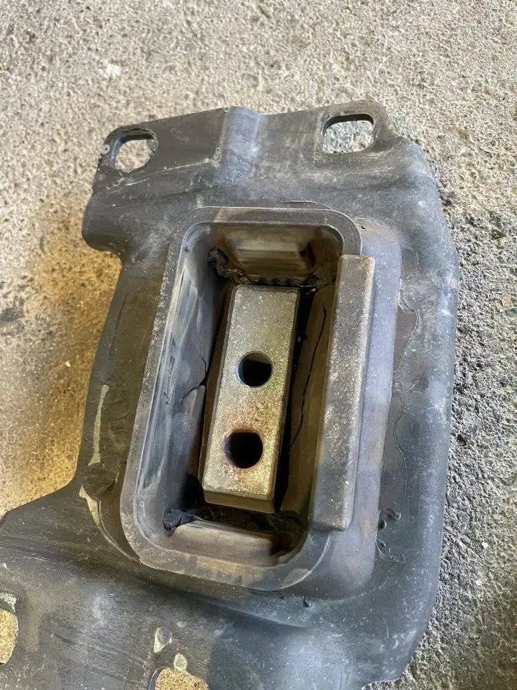

I just got the mount out and it’s cracked all to hell. My issue is there’s a little rectangular rubber piece which goes around (under) where the mount attaches to the transmission. I’ve seen in walkthroughs that this piece is just reused on the new mount, but mine appears to be missing a piece as it should be a continuos loop vs a U.
my new mount (rock auto) didn’t come with that piece. Everything is disassembled now and the mount is out. Will I have issues if I reinstall that broken piece? I can’t keep the car non-driveable for more than a day, and I somehow doubt a dealer stocks that random piece. I’m pretty sure the important parts of that insert are the sides with the top/bottom just connecting them. I don’t think it will cause an issue….. just wondering if anyone else can comment.
here’s the old broken mount.

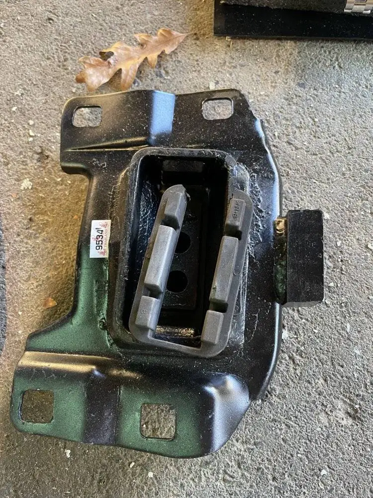

here’s the new mount with the broken rubber piece on top of it.

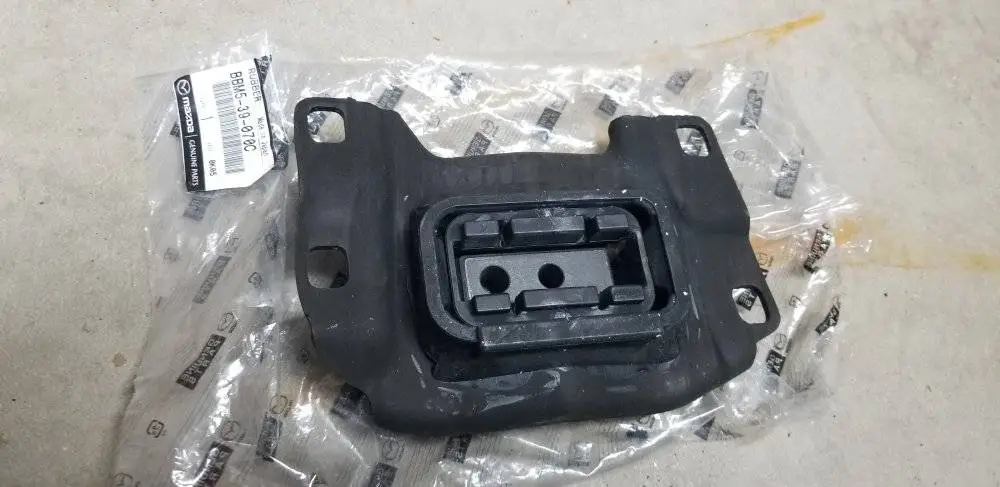

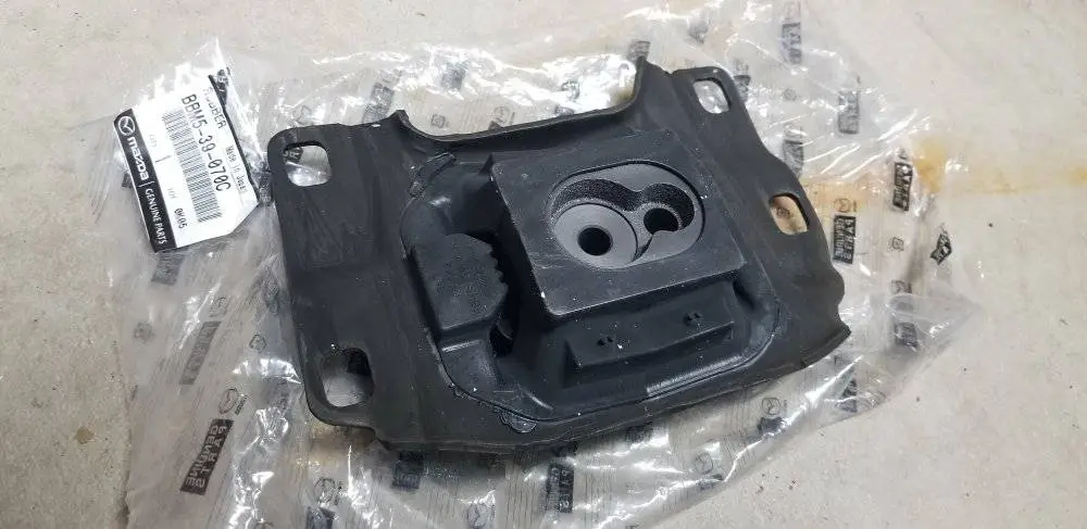

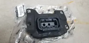

I am actually about to do the same thing. I got mine on Amazon, but it's one of Mazda dealers that actually ships the part. No Prime shipping, but I paid $110 plus tax. It's still available for $113, part number BBM5-39-070C. I took pictures of top and bottom, if it helps.

Wasn’t looking for a critique of buying aftermarket parts. All videos or walkthroughs I’ve found on replacing that mount have I guess been from installs where that part wasn’t included new with the mount and the rubber piece was reused. It just happens that mine is missing that little rubber piece along one end, probably because the actual mount was cracked all to hell.
That little insert isn’t load bearing….. the transmission mates directly to the face of the mount. It looks like the insert just is there take up space in the void around the mount surfaces. The little 1/8” thick piece of rubber along the edges is in no way load bearing in any way shape or form.
Why would I reinstall a busted part? Because I’d already removed a broken mount, I had my engine supported on a jack, and I couldn’t leave it there. I now I have a fully functioning non broken mount, and have no issues at all with that piece in there missing an inch long piece of connective rubber. Now if I’d realized that OEM (and actually some aftermarket mounts) came with that piece as a replacement as well I would have ordered those. Once the broken mount was out was a little late to be dealing with it. Was curious if anyone else had encountered that before.

The mount I ordered arrived perfectly fine. It just didn’t include the little insert. That little piece of rubber is broken off of the insert I have. Reinstalled it anyway because I couldn’t just leave it disassembled. Will look into finding if I can replace just that piece.
