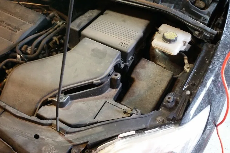

Before
Step 1. Remove air intake, battery cover, battery, and battery box. There will be some electrical connectors and a vacuum line that need disconnection.

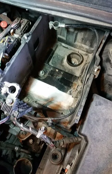

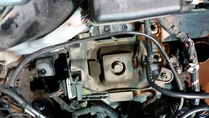

Step 2. Under the battery box, there is a bracket covering the trans mount. Remove it and you'll see the entire mount.

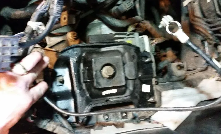

Step 3. Put a jack under the transmission to support it, then remove 17mm bolt through the center of the mount. Remove old mount and put in the new one. Torque the 17mm bolt to 75 ft/lb then remove the jack below.
Step 4. Replace the bracket, battery box, air intake and re-connect all lines and electrical connections.

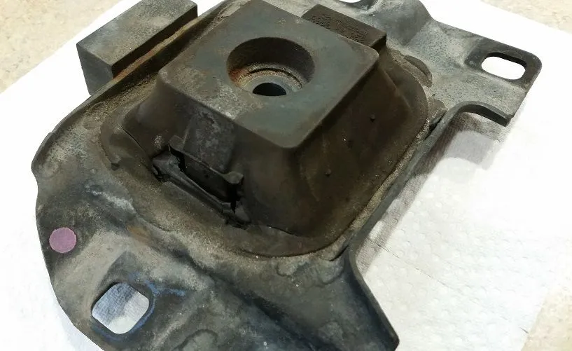

Here's what the old transmission mount looked like once I took it out. From some others that I've seen I thought my old mount looked pretty good, but then I noticed the thin crack along the left edge. It's a split in the rubber that went the entire width of the mount. It wasn't completely falling apart but it was on its way out.
Before
