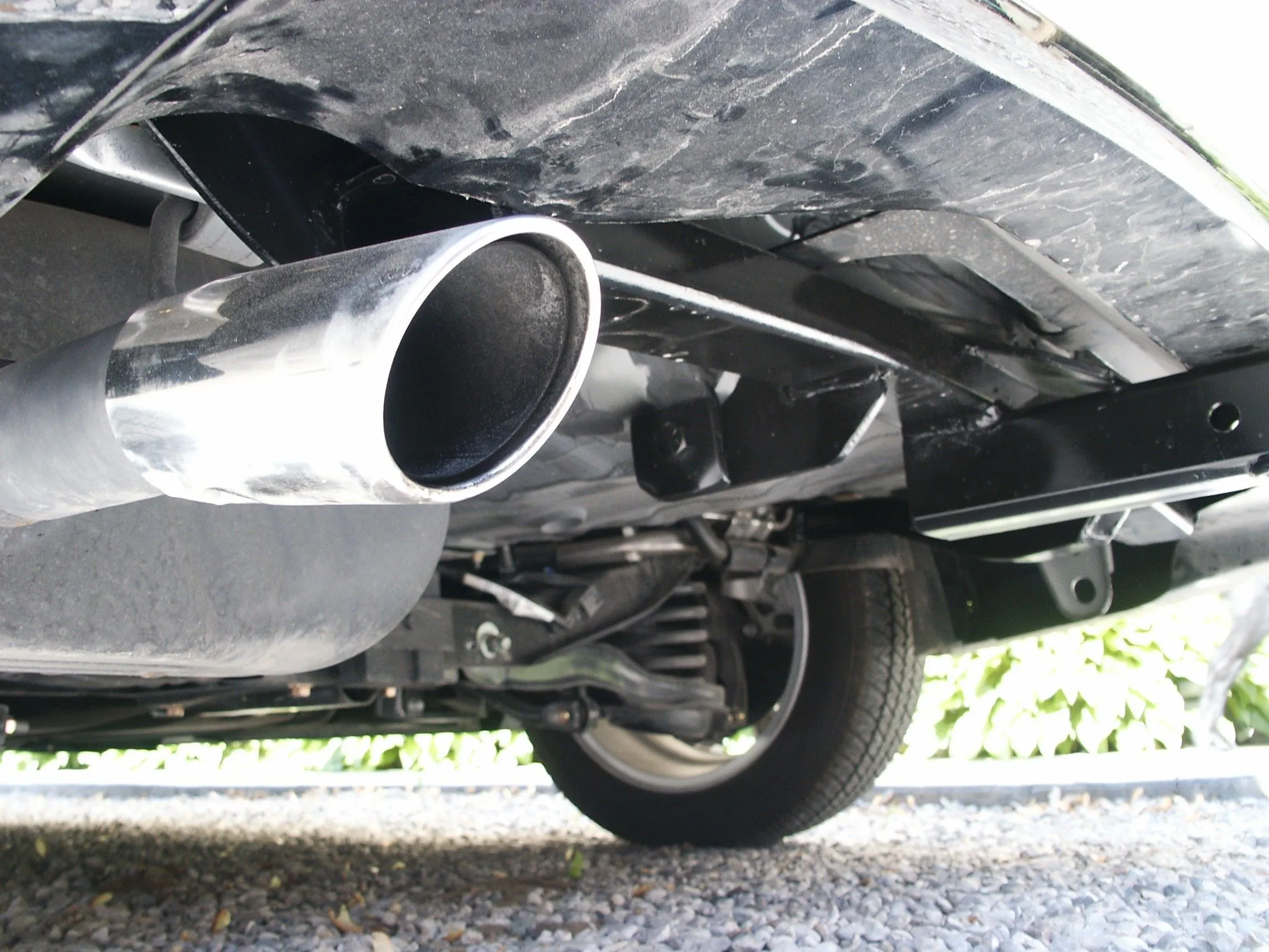

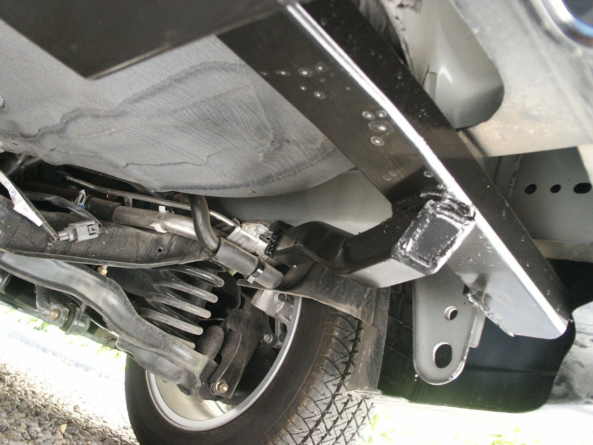

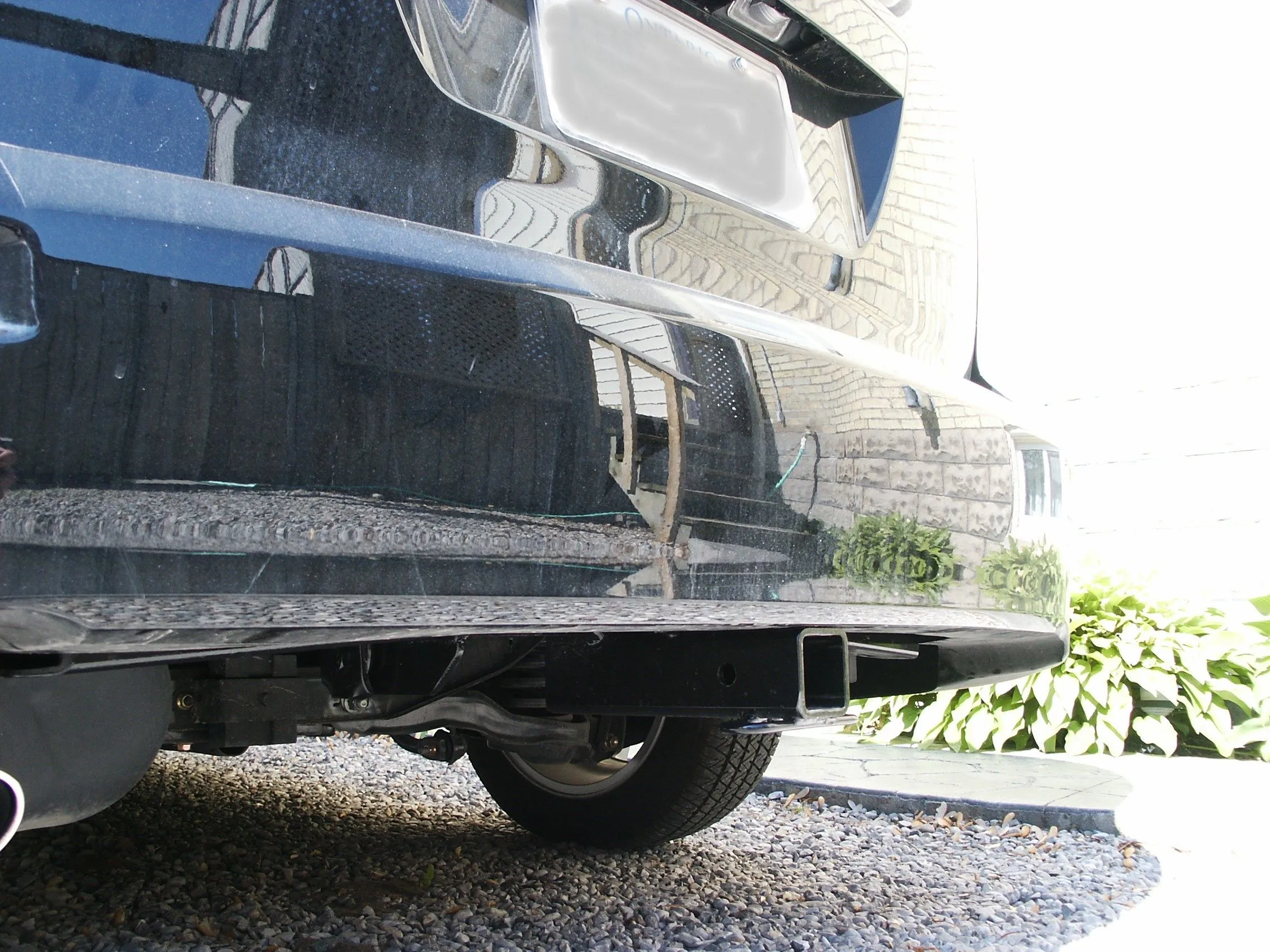

Heres a few pics of the "custom" trailer hitch.
[/ATTACH][/ATTACH]
He reinforced it in a couple of places.. I think it'll work !!

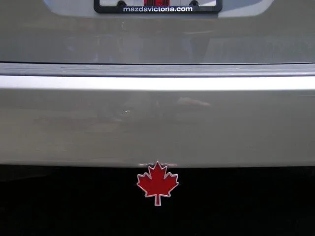

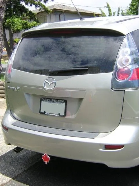

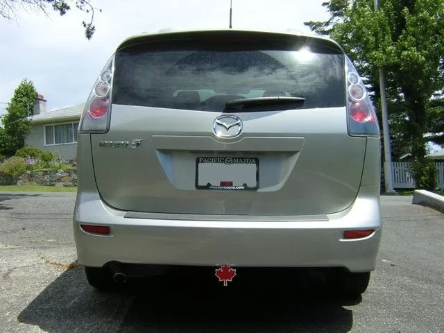

Got a new hitch cover for some fun.
Oddly enough I got the Canadian Maple Leaf from a guy in Texas! Its home made from aluminum and is very well done.(canada)
Secured with a locking hitch pin I got with my bike rack.

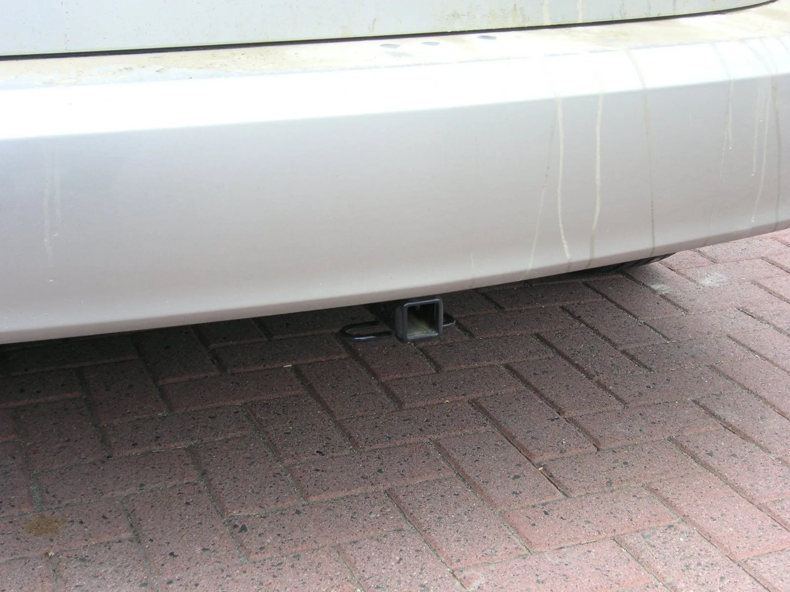

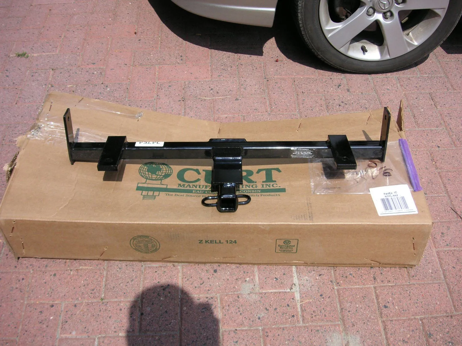

If anyone is interested, I have an extra class I Curt trailer hitch for sale. I bought two, one for my 5 and one for a friends, but now they don't want it. It has never been installed. The hitch installs quite easily and is barely noticeable on the car.
Steve
