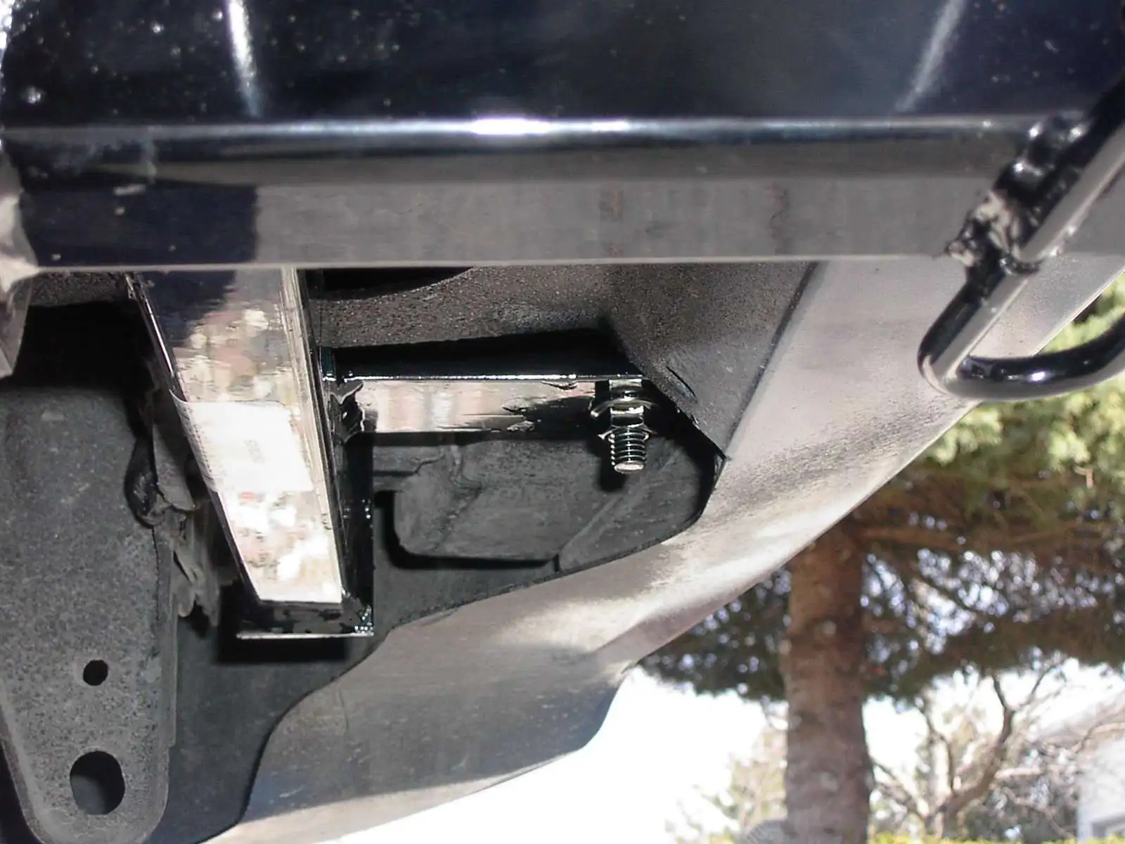

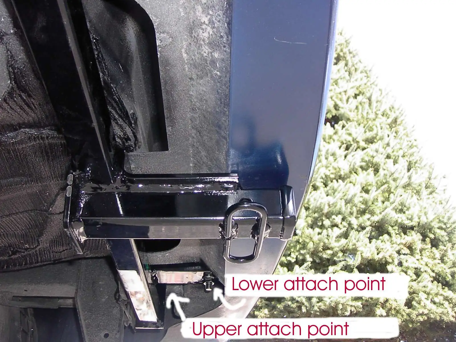

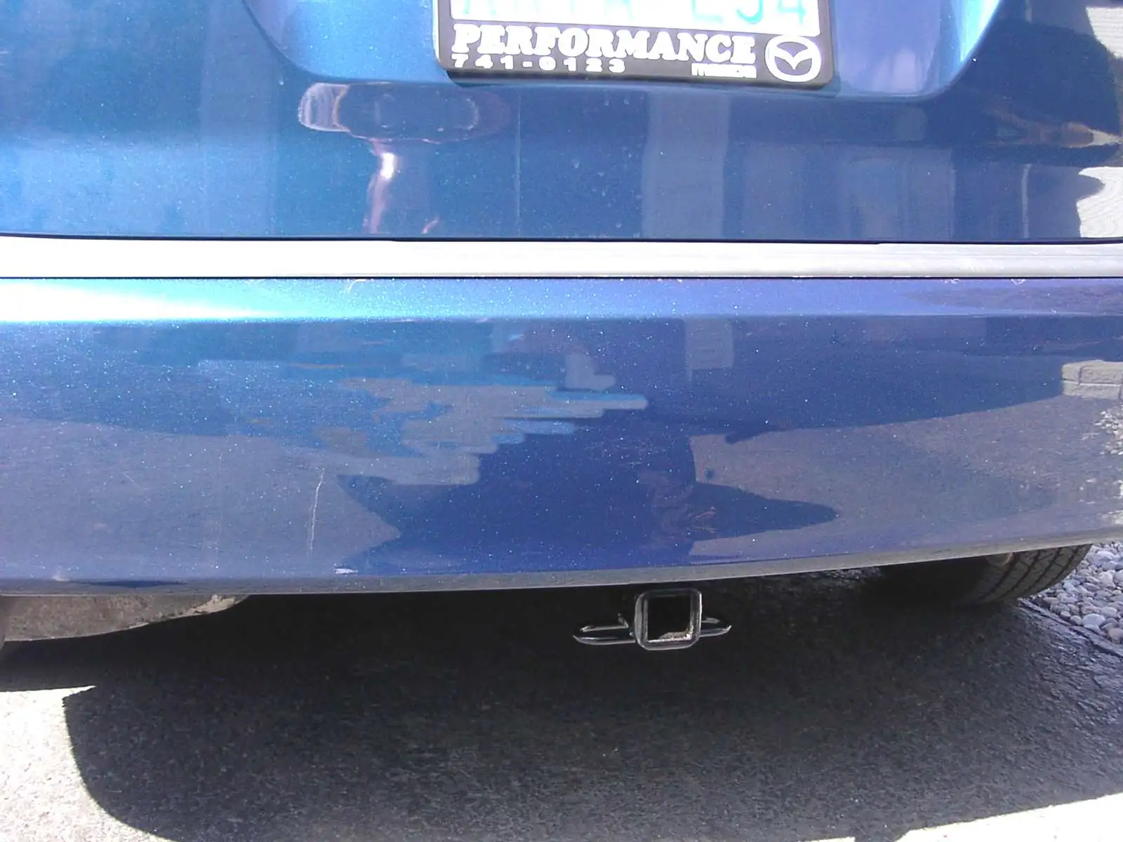

I did some reading and found the end bolts go straight thru the bumper support. Thanks for the help.
Installed the hitch in about 35 min or so (really was a 1 pint job for those that cant tell time). Only had to enlarge the two lower attachment points for bolt to fit in the hole. Painted up the new bolts and presto new hitch installed.
Below are some pics....

Very nice Zoom5Zoom - well done!
Where did you get your hitch and what did you pay for it?
What tools did you need?
Are you planning to install wiring for towing??
Thanks
I got my hitch from the dealer. It is a curtis hitch.....
Electric Drill (to enlarge lower holes), Snag wire to feed bolts down bumper to drop in holes and lastly rachet set.
Not yet as I have a second vehicle for towing our trailer. But because the lights on the 5 are so high my trailer is just a canadian tire 4x4 ft special (like I can even carry it into my shed) I will most likely not wire it.

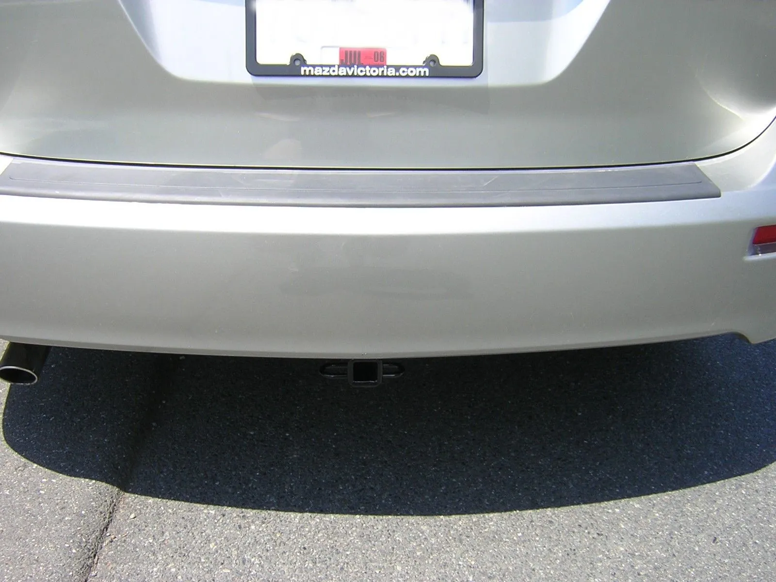

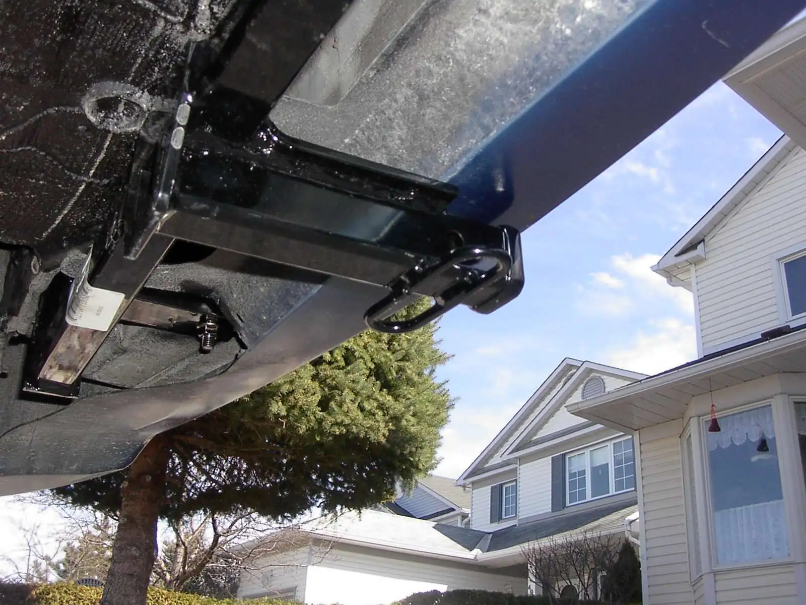

I finally got a hitch installed - no wiring - I haven't decided on what to do in that regard.
I went with the U-Haul Hitch - looks very similar (if not exactly the same) to the Curtis hitch.
I had the U-Haul guys do the install. Cost $210 CDN including all taxes and lifetime warranty for replacement in the event of accident or stupidity!!
