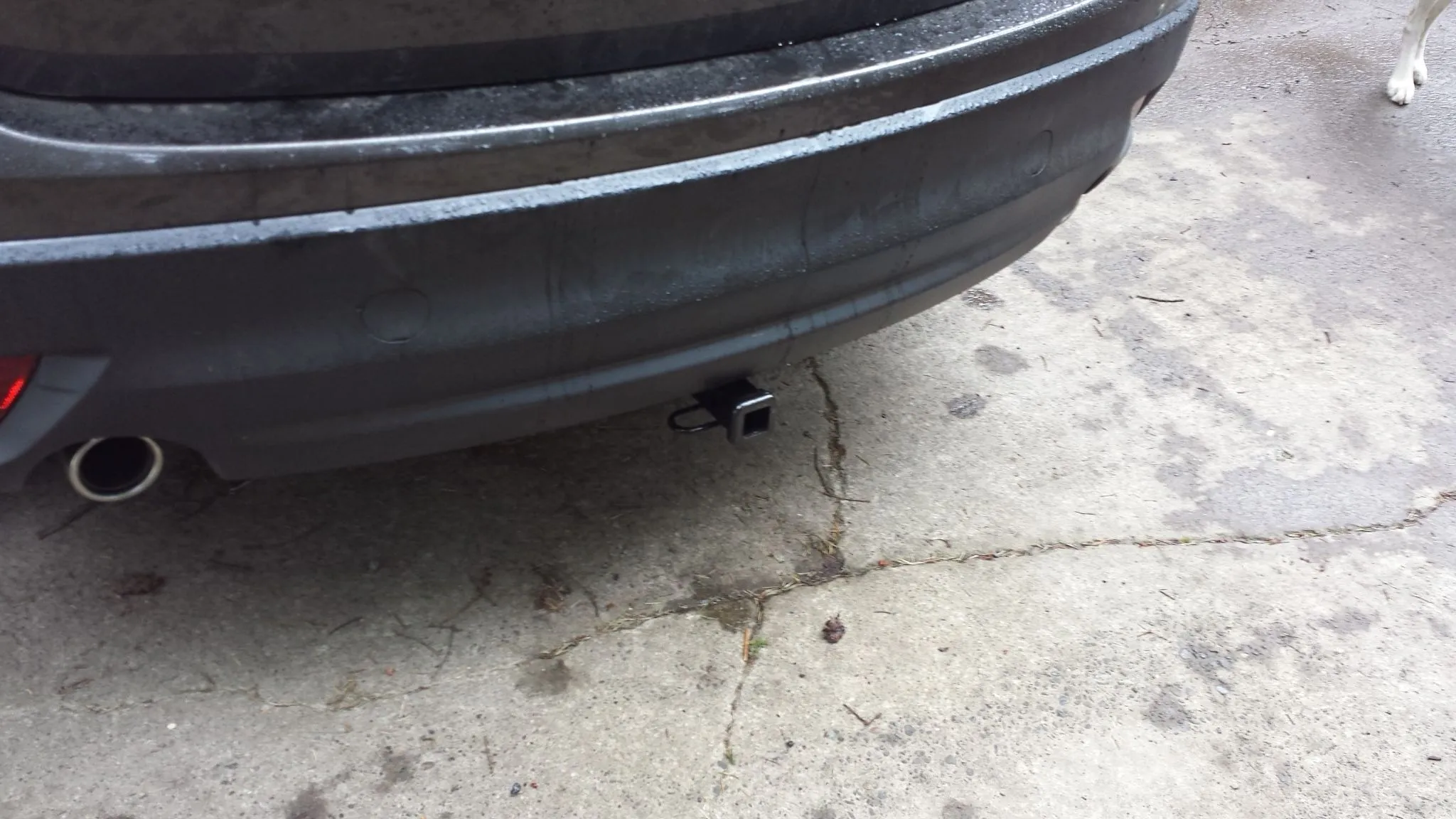

Took 45 Mins to install,
Lots of videos helped, I removed the Muffler, it was only two 14mm (9/16") nuts. Deep socket. And the hitch install nuts were 19mm (3/4") Deep socket. I used my legs to hold up the left side of the receiver while I threaded a right nut on. I centered it by matching the unit to the cars frame rails. Ez job. Curt 12080 Now for the wiring!!
