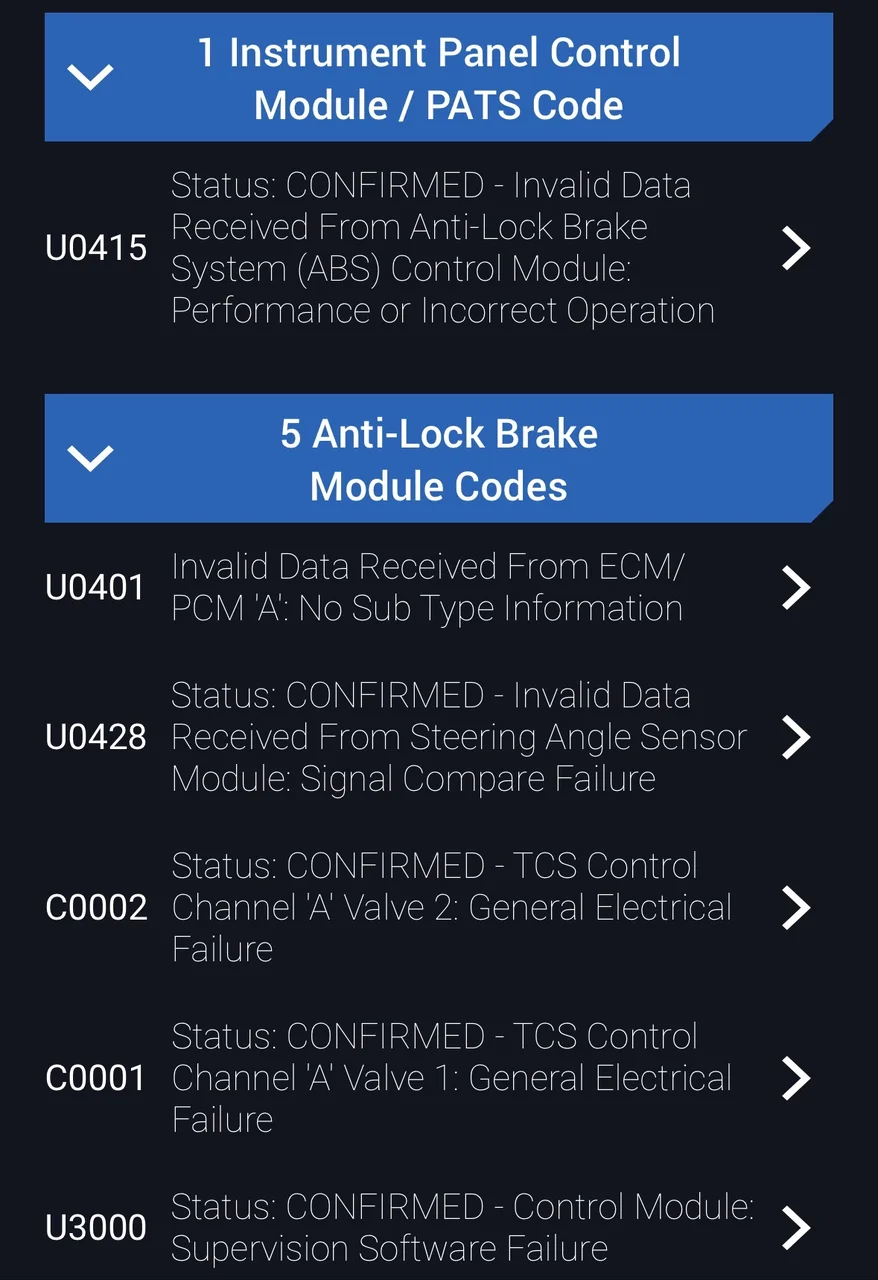

I had a more in depth scan today:
Possibilities listed:
- TCM (not possible as it’s a manual)
- Steering angle sensor
- ABS module
- TCS module (seems to be the ABS on my car?)
I was not able to find the option to monitor each wheel sensor

Abs worked fine a couple times, then faulted with U0415:92 and U3000:48 codes
Sounds like an ABS sensor going south. I would goto a garage with a professional scanner and get it on a ramp to see if the wires are all good.
