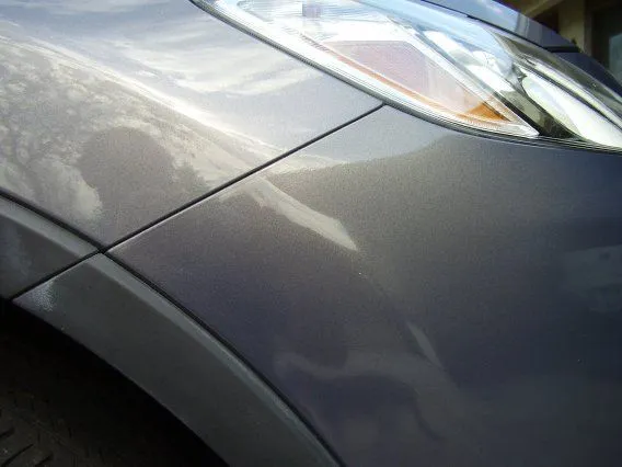

Here's the pic of the chip. It's pretty nasty and a little under 1/2" long. There are some wicked reflections in the pic, so hopefully you can make it out. It's dead center in the picture just above the tape. Thanks for the help.
Actually, you did that perfect. The phone makes a dark backdrop for the chip.
Is the chip only in the paint, or did the primer chip also? I can't quite tell, but that looks like primer.
You definitely don't need to get crazy with the repair. Mine was a series of gouges up to 1/4" wide and several inches long, with some other scrapes.

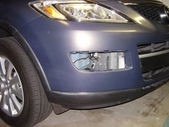

See how dull the pain is in photo 3 vs photo 4 of my repair? The clear does not go on glossy. It has to be buffed. The photos aren't that great. In person it's a very good match for paint and sheen.
Here is another look just before I buffed the lacquer:

Took a photo at an equal angle, just to show the color match...
I just noticed that the cat was behind me.
Thanks. The mica density and depth is slightly different, but that's mainly to me not layering it as much. It's still a pretty good match, since only I can see it.
Not bad for 3 hours work.

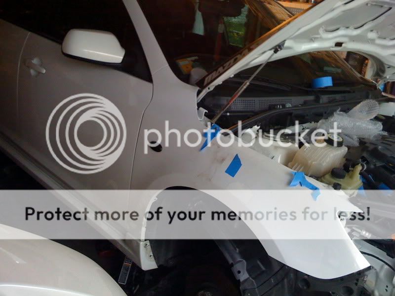

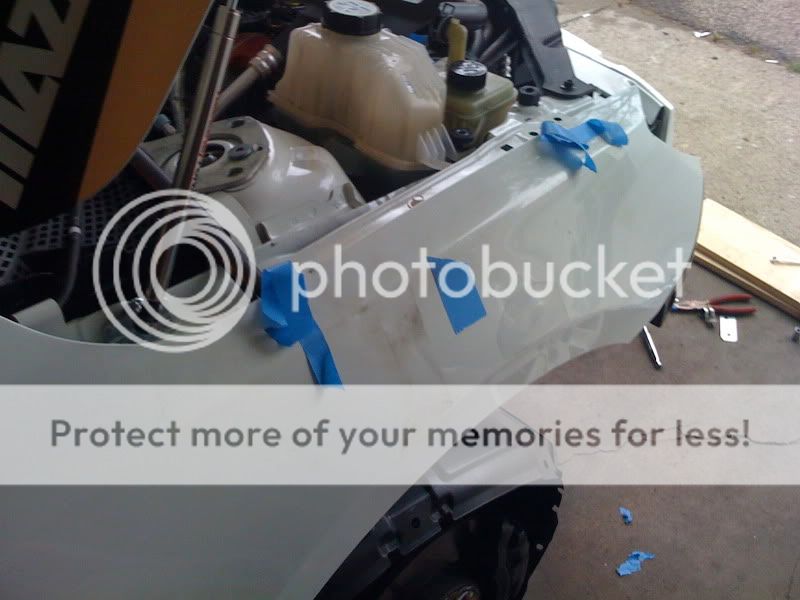

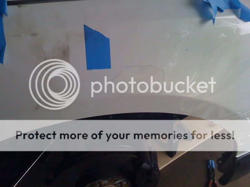

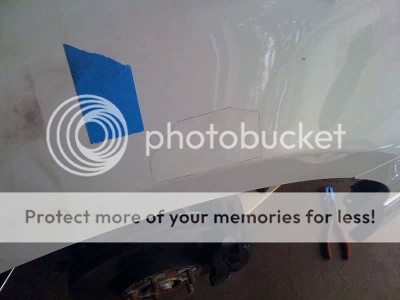

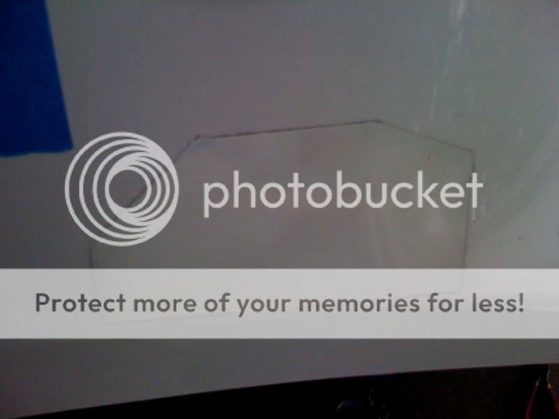

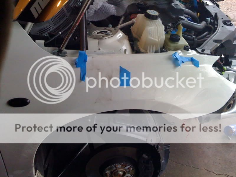

Alright, so here are the pictures. Please note I used regular white paint after I used bondo and primer to see if I'm going to have these uneven buildups of paint around the corners where the masking tape was- and I did. It was just a cheap cost effective way of not wasting expensive ass paint that 34K is.
Nevertheless, here are the pictures, I will be working later today or tomorrow on sanding down that area again.
The reason the outlines in picture three are so dirty is because the car has been sitting there for over a week now- as you can see I'm working on other things as well; oily and dirty hands will do that....
I'll post new pictures when I mask off that area again and finish sanding it down.

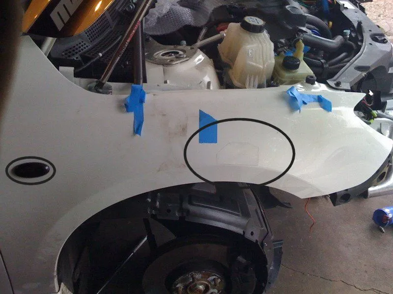

Yeah, the spot is metal. So, far I applied bondo to fill in the deep cracks (all the way to metal) then I sanded that down and applied general automotive primer.
Fine sand the spot I marked until it's smooth. for the final presand, I use those 3M SandBlaster Flexible Finishing Pads. 320, then 400. They will smooth the surface without gouging.
To check for any remaining scratches, wipe the area with a lightly damp towel.
Clean the entire fender VERY well.
Tape off the exposed edges, behind the exterior surface. (Inside the hood, the headlight flange, etc.
Tape the oval black thing I circled, and the leading edge of the door.
Tape off the lower rocker molding.
Cover the Wheel or Hub, and engine with newspaper, etc.
You want the entire fender exposed, except that black thing.
When you paint, you will do back and forth bursts slightly beyond the spot you sanded, top to bottom. Nice light coats. Smooth, but not rough or glossy.
Wait 15 minutes between coats. Apply at least 3 coats. 4 is better.
Wait 30 minutes.
Spray the lacquer the same way as the paint, but overlap the paint by a few inches.
Wait 15 minutes between coats. Apply 4 coats.
The finish will be dull. Don't panic, you didn't do it wrong.
Wait 4 days and then use the rubbing compound to polish the clear coat. If you have a power buffer, use it. Otherwise it will take many applications to get the shine. I used a simple faux lambs wool pad in my drill. Keep moving so you don't burn the paint, if you use one. Wait 30 days to use any paste finishes.
That's it. If anything is unclear, ask.

1st: the black oval (side reflector) I will completely remove when repainting. It takes like 5 seconds to remove the whole reflector so I will mask that exposed whole from the inside of the fender.
OK. So from what I understand is this: I tape everything off- first mask the entire fender's edges. Then, like you said, obviously cover everything else...wheel, engine, etc. Bottom line, have nothing but the WHOLE fender exposed.
Now, the larger area that you have circled, I don't need to mask that, right? I just sand down that area like you said? (That's what you did looking from your pictures) if so, I'm understanding this and I am on the right track...
So, with everything covered and that area sanded- I am just repairing or I should say repainting just that area and not the whole fender- even with the clear coat/lacquer, correct?
Even easier.
Correct
Also correct. You will sand where I circled, and then paint that area.
Yes. Just that spot.
