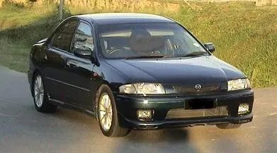

I don't know why Mazda maintain the top speed only 160km/h. In the speedometer it self maximum speed was 220km/h and when I drove to maximum speed at 160km/h the RPM still at 4500 still far to go RedLine 6500. I feel ashame everytime I drove thru highway I was easily bypass by 1.3L cars even diesel cars like Nissan Sunny and Toyota Corolla. My car detail is Mazda 323 1.6GLX(A) BA, Engine Type: B6 DOHC 16 valves, Model 1996.
