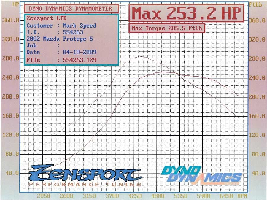

the power differences are so different... cant wait for my KL now!! to boost? or not to boost? that... my friends is the true question...
My dynos are up here, but they haven't been updated... so far I've got 123 whp on the dynojet (a long-a$$ time ago), 141 on the Dynapack with the same mods (apparently, the calibration is wildly different) and over 140 on the Dastek with my current set-up (about 30 up from another guy (stock 142 bhp) on the same machine, and about ten more than a stock B16A)... but I don't know if this particular Dastek is calibrated 1:1 with the Dynojet, it's supposed to be, but we've yet to verify... I've seen some wild numbers out of other Dasteks... so don't add me to the list yet.

We should start noting the type of dyno and the actual dyno since we're comparing apples and oranges here.
