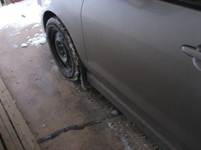

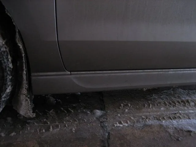

Soooo I picked up a set of plain black flexible flaps at the local Canadian Tire store and installed them with the break away clips. (Just in case) This was just before the winter season started. (Think ice, snow, slush, wet and sandy salt spray). Our roads over the winter are covered with a mixture of road salt and sand. Therefore when you drive over the stuff with winter tires, or tires of a larger tread design, the stones are picked up and thrown about. If you think about it, I am salt sand blasting the unprotected part of the car. Ive seen many cars with the doors falling apart from the bottom.

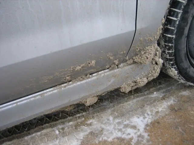

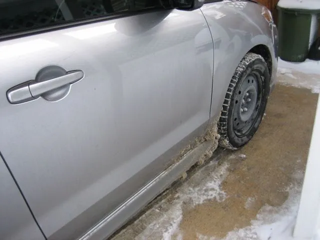

Due to and excessive amount of ice build up one of my flaps got torn off. I did notice that these flexible flaps are not very flexible when exposed to very cold (-25 deg C) weather and its stiff state likely contributed to being torn off. Im currently looking for a better solution. I chose not to replace the flap for now and found myself driving in a very warm (-2 deg C) slushy condition this past weekend. I just wanted to show you all the difference between using flaps and no flaps. Driver side with flap nothing on or near the door. Passenger side without flap what a mess. This sticky slush is full of sand and salt.
