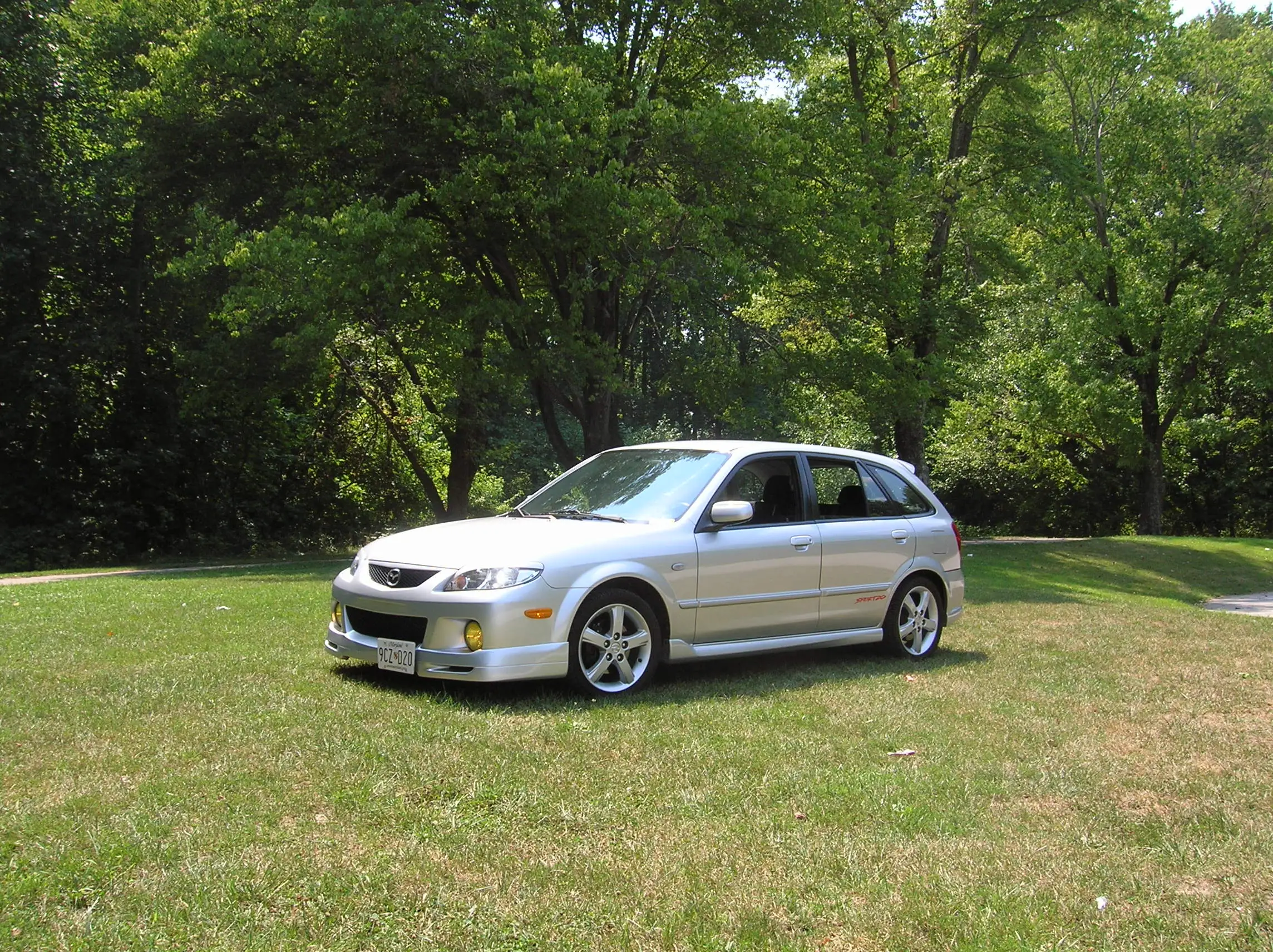

let's ***** out this pic of my car once more. 205/50-16 on stockies. sometimes i wonder why i traded it in.
or you can go 205/45/16 and buy my stock rims with almost new toyo proxes fz4's ;)
