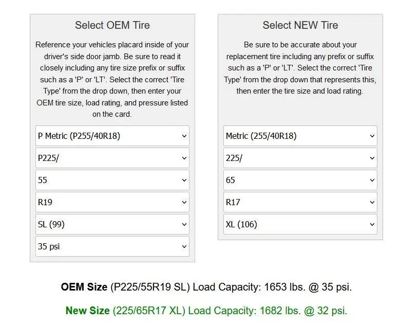

@FerrariF1 Thank you for the link, very helpful. If I entered the correct info, it shows 32psi.
