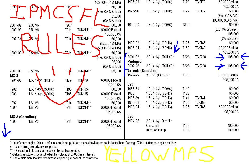

the question still remains: does the MP5 have an interference engine or not? (attn)
Ok so your attachment says we don't have to change our timing belts till 105K miles? I want to make sure because I've always been told and done them around 60K miles.
02MazPro5 said:
Ok so your attachment says we don't have to change our timing belts till 105 Kilometers? I want to make sure because I've always been told and done them around 60K miles.
Kilometers
yea i would get it done before 100 but u could wait a lil after 60 i would say, ill prolly wait till around late 70s to do mine, the wifes was done around 60 and it still had more time left in it.
manual says around 60K miles and im pretty sure the 2.0 FS is non interference. Ill do some research as ive been out of the game for a minute and ill update.
Manual says 105,000 mi (168,000km) Canada/US for replacement.
60,000 mi is for Inspection.
60,000 mi replacement is for Chile.
Hope this helps.
