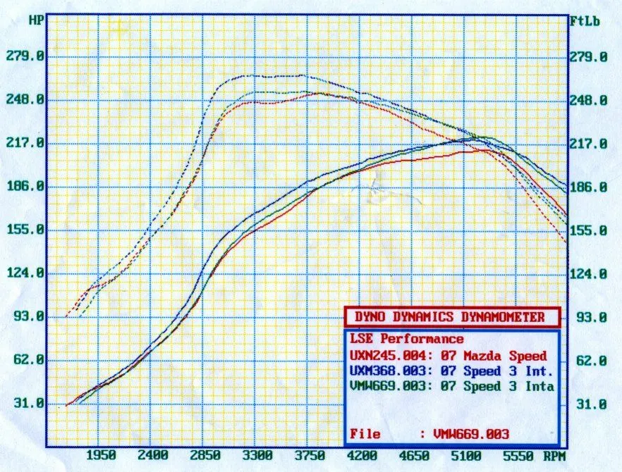

I also have an actual dyno graph of three of my local car sites members dynoing on LSE's "not conservative" Dyno Dynamics :rolleyes:
Red is stock.
Green has a CPE CAI(me).
Blue has a MS CAI and Turbo XS race pipe.
Similar to your comparison. Looks like 20-30hp difference between your dynojets and the Dyno Dynamics I was on... Hrm

I'm not trying to bash you or anything...but with the mods in your sig you are no where near 300 whp. Adding exhaust with the intake is not much of an increase in top end power though torque jumps up a bit. This has been proven on other MS3's and MS6's even with the Standback/Exede. I will say though that you have a nice looking car with a good mod list! :)
To the OP, nice numbers! Yes they are a little overstated but are inline with the cars that you compared to such as the Evo IX which is right where they should be.
