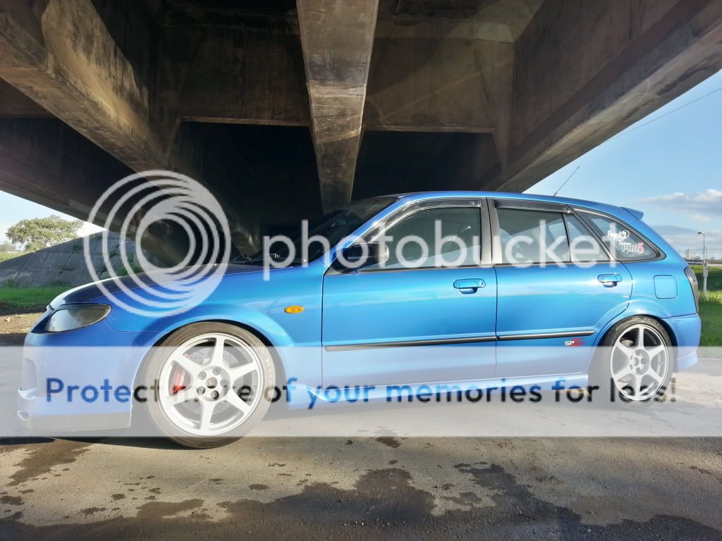

went out filming today and stopped to take a few shots. This is one of a few I took, Also had some new graphics put on too
<a href="http://www.flickr.com/photos/71999981@N03/11299673766/" title="brhrun by korbancorbett, on Flickr"><img src="http://farm4.staticflickr.com/3824/11299673766_9dd7e9d1ab_z.jpg" width="640" height="427" alt="brhrun"></a>
