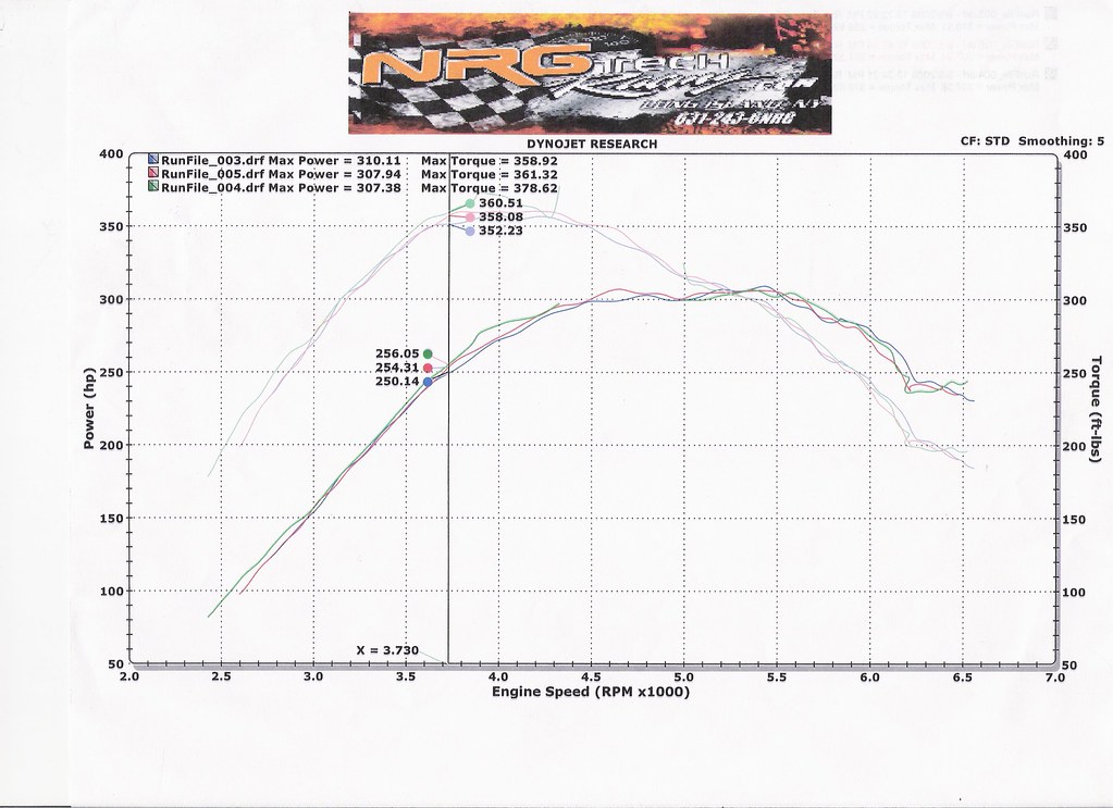

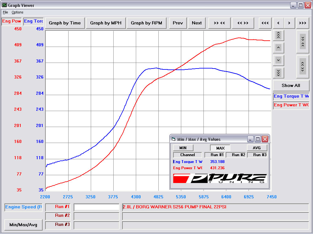

Case and point, look at the tq and hp on this 450whp evo
Now look at Darksun's dyno. Again look at the torque he made.
Take a look at this recent DISI dyno. 375 ft lbs at 3000 RPM.
