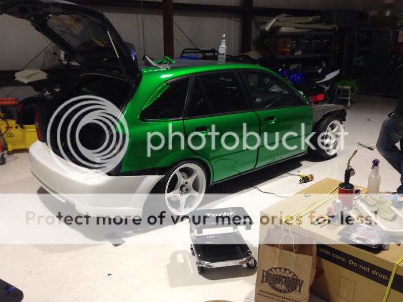

Stock (2004-ish?)

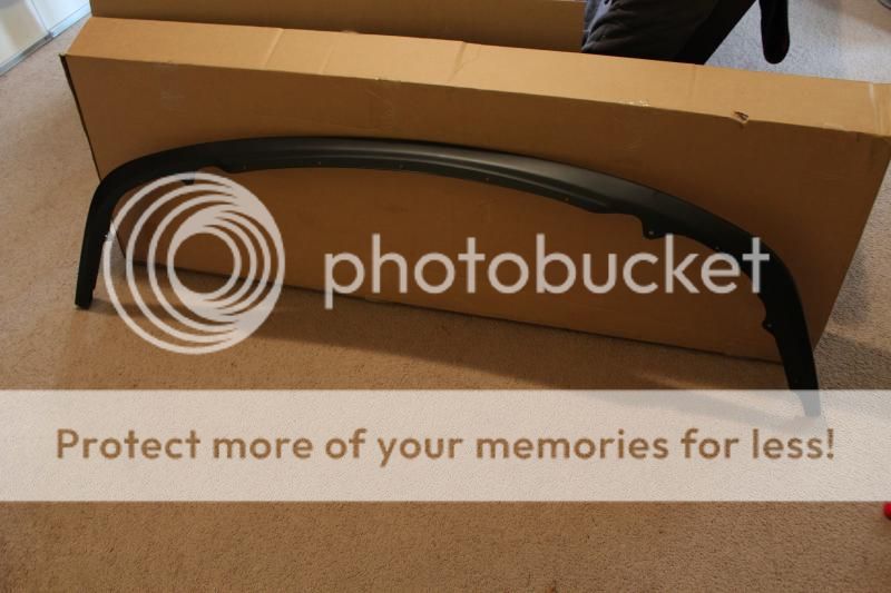

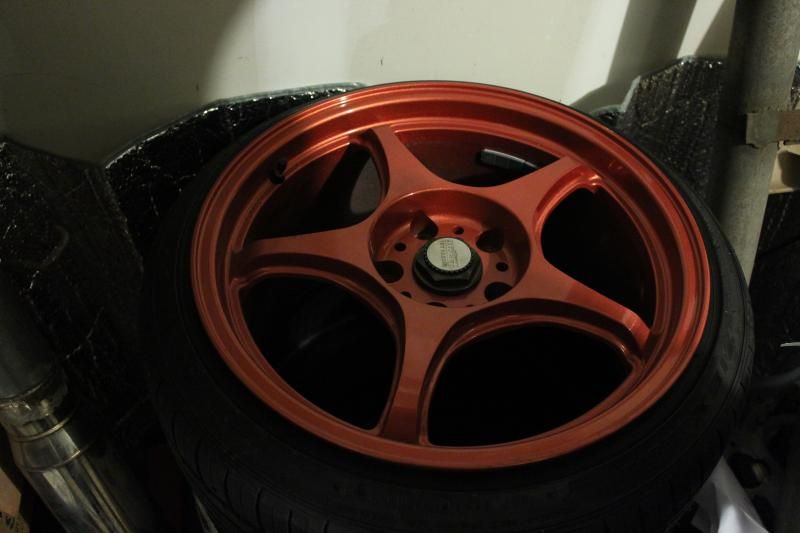

Carbon Hood, eyelids, wheels, lowered.
Coilovers

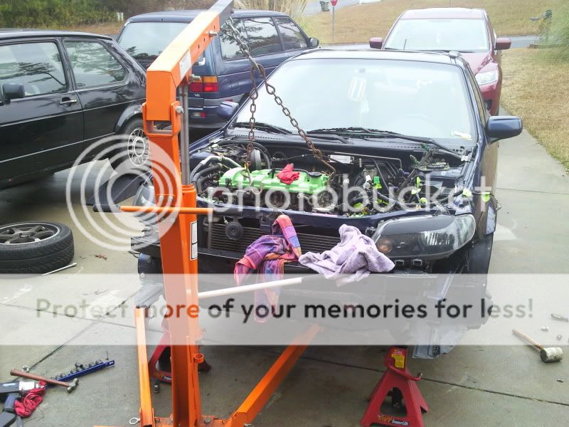

Engine coming out

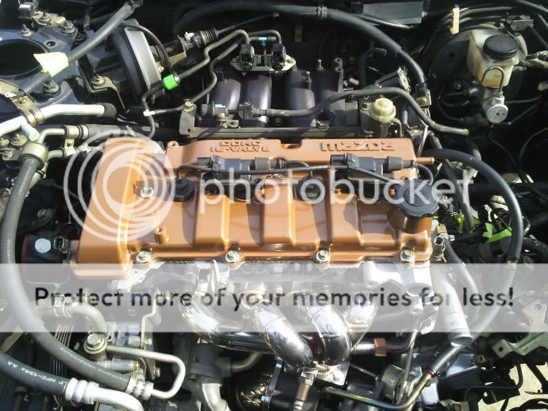

Putting shiney stuff in
Back together for the first time after the build

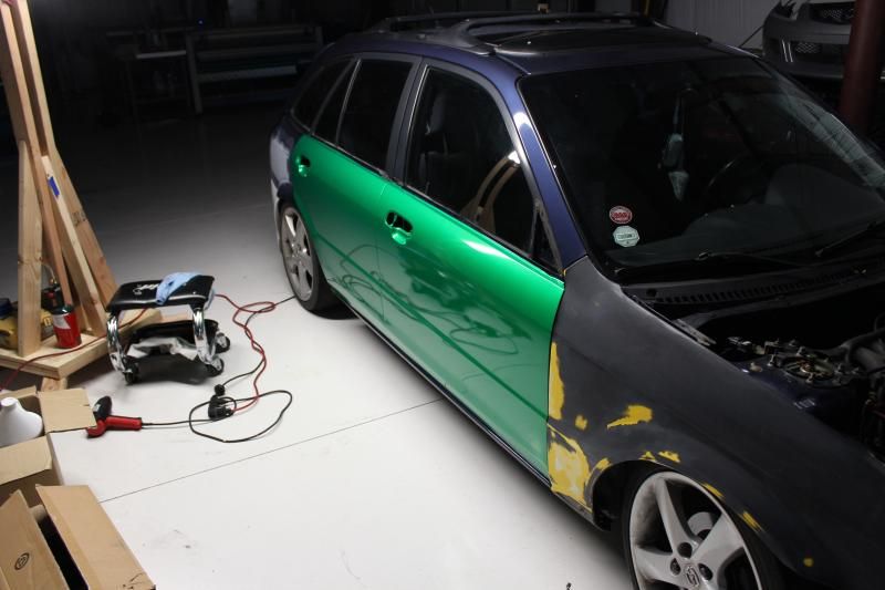

Now Im going to skip some stuff, but basically, ran like that a while, burnt an exhaust valve, rebuilt the head with all Supertech Valvetrain, then upgraded to a bigger turbo. Oh and I started wrapping it

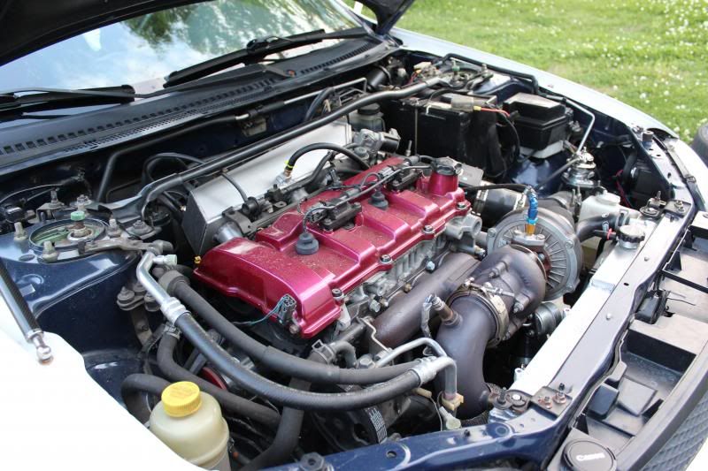

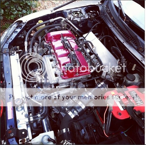

The final setup was:
*Steedspeed T3 turbo manifold
*Garrett T3/To4E Turbo
*Pauter rods/Wiseco Pistons (8.5:1)
*Arp Head and main studs
*Supertech: 1mm Oversize Valves, Dual Valve Springs, Ti Retainers, Bronze Valve guides, Valve seals
*Stage 2 clutch
*SSAFC
*Etc etc

Engine coming out
