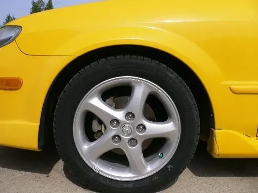

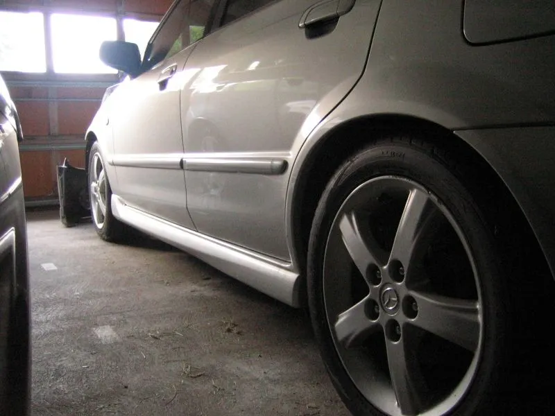

Nope, I already obtained the springs. RB are slightly used, <15K miles, Teins are new. They'd be $160 shipped to Utah, I'll get proper pics if you're interested. Drop would look like the attached photos: silver P5 has Teins and 195/50s, Yellow has RB and 205/50, both have HPs.
