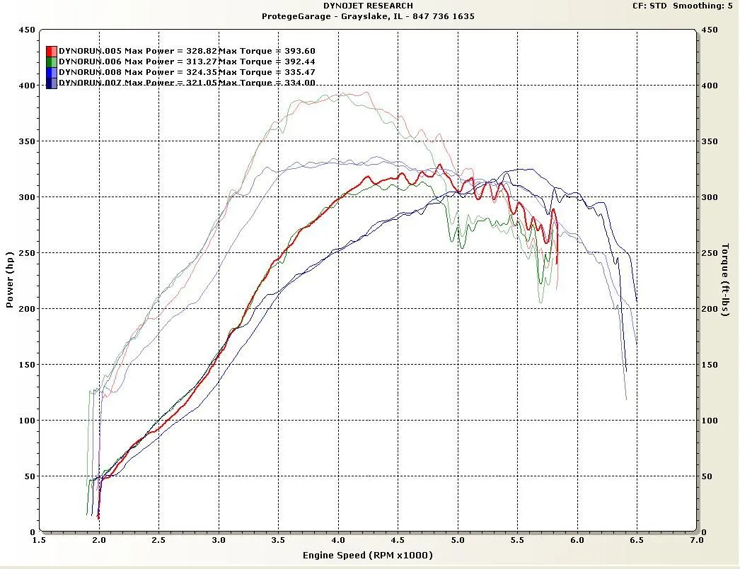

can you or Jason attach the dyno graph and video?
I've never seen it.
I've heard the hp/tq number quotes before though
Here you are woosh....now please make sure that if you compare this to yours or repost that you keep in mind that this was with that stupid map clamp from atp and the xede. I cant post the other dynos because they were on my other computer that freakn crashed. The atp fcd is the reason that its all crazy in the high rpms. I figured though that this would suffice.(hump)

If Whoosh put down 367 on a dynojet, thats about 327 on a mustang.. which is exactly what I put down at 17lbs with my GT3071R. Something isn't right.
I know whoosh can get more power with better tuning, better temps/cooling =)
I also still need to fix my fkn standback, the car rarely turns on when installed and CP-E is NOT replying to emails or my phone call, ridiculous. Been 2+ months.
Anyhow, once fixed, I need to tune my top end, on the dyno. my map was borrowed from another member who street tuned it himself, with no timing adjustments. tuning teh top end with a GT30 should yield a few more ponies and leaning it out will increase the torque curve (how jcg got 390+lbs/tq).
