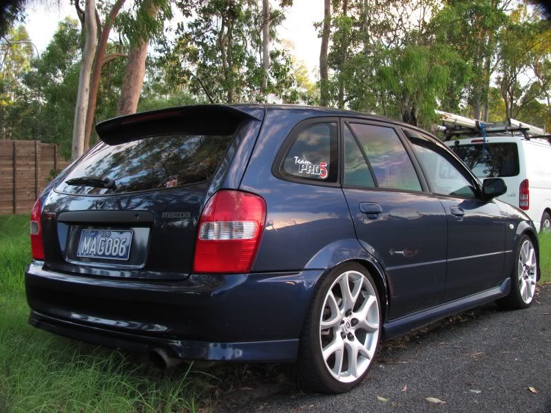

Yup your the first! Hey what kind of window visor are those you got? Really like that look
Those came with the car stock. They usually came with the JDM Sport 20 but I guess how they did this edition they just put them on the car. There are a few bits of stuff that look different from the original RSS (Familia S-Wagon) that was the base for the @Navisport. I took them off recently because the one on the driver side started to develop cracks. I think they are JDM as the Sport 20 has it and could quite possibly be sourced from Japan or even Australia. Sadly I won't be putting them back on, however one of my buddies in our crew has taken them to mold them in Carbon Fiber. I could always talk to him and see if he is willing to do a small production run for you guys.

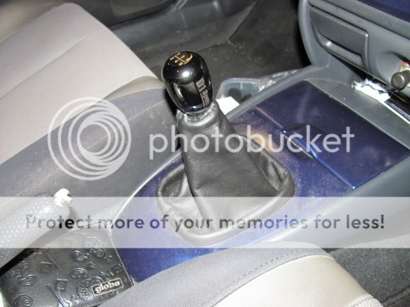

- Mazdaspeed Protege 2003.5 Gear knob
