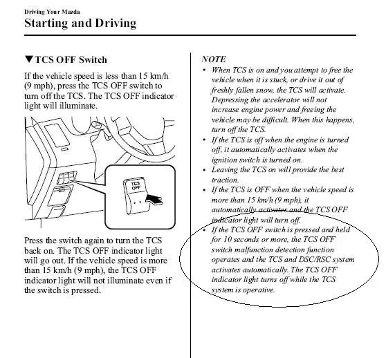

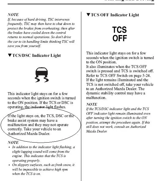

For TCS, see attached screenshots from the owners manual. Try to hold the TCS button for 10 seconds and see if it fixes it.

Thanks. I've tried to reset it with no luck. When I turn the car off the light seems to reset but then comes back on as soon as the car is put in gear.

Later, on the manual, I read that the TCS can go off to prevent overheating of the brakes when this system is used many times. (thumb)
