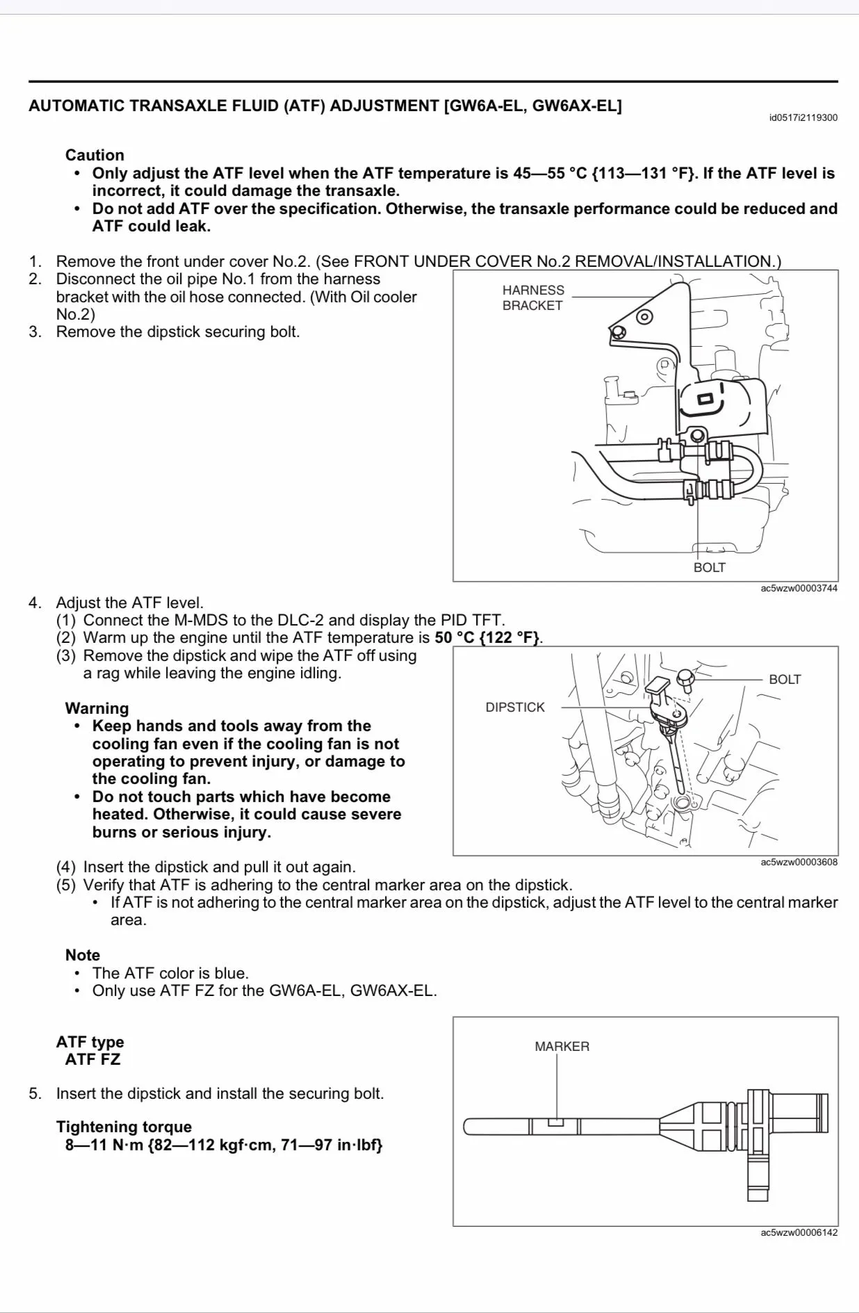

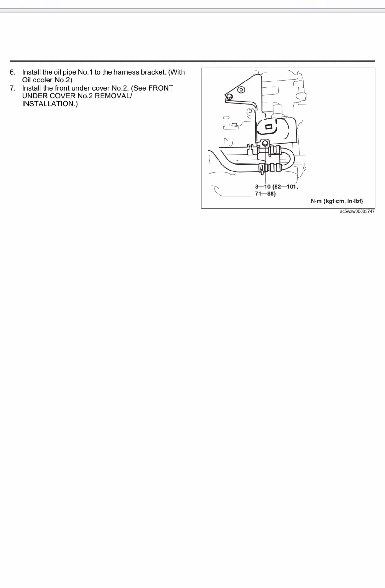

Kedis82ZE8 original post had a picture showing the ATF level was below the “L” mark from factory. But the picture was gone after the server update. And the ATF level needs to be in the “central marker area” of the dipstick, not just between “L” and “H” marks like you stated.
Mine was just shy of this lower mark at 122F
If that red mark was where yours is, that was the same as mine.
I drained 3.5 qts from factory fill, after some experimentation, a refill of 3.7 qts got my level in the marker.

I agree that routinely checking ATF is not necessary as the ATF won’t be consumed like engine oil. But on our CX-5 case there’re too many reports from those who bothered to check, that the AFT is under-filled from factory. An early checking and adjusting of ATF level from factory definitely is beneficial!
Don’t forget checking the rear differential gear lubricant too as it’s also under-filled from factory!
