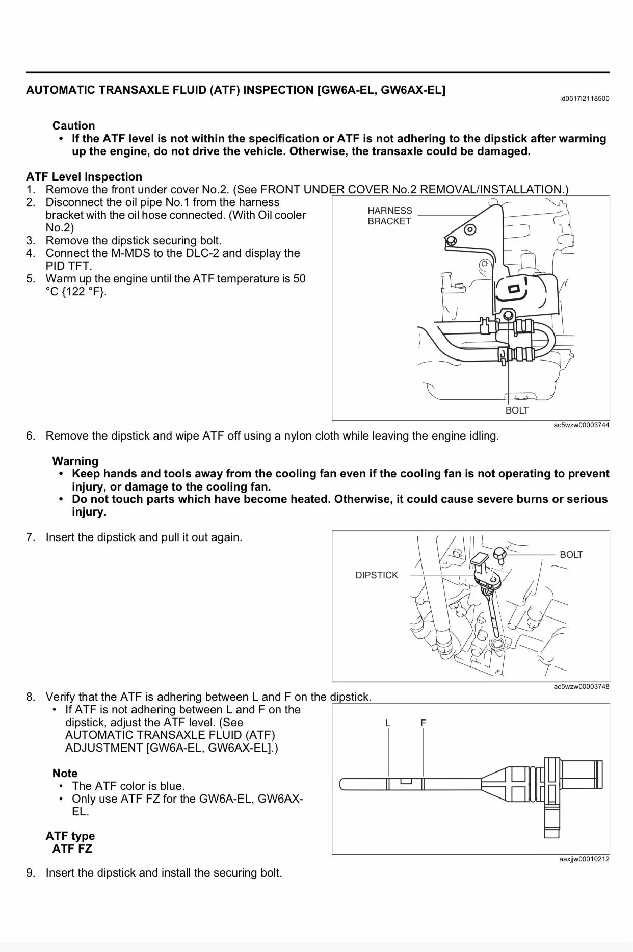

Anyone have a picture of where the dipstick on the turbo is? I looked and couldn’t find it.

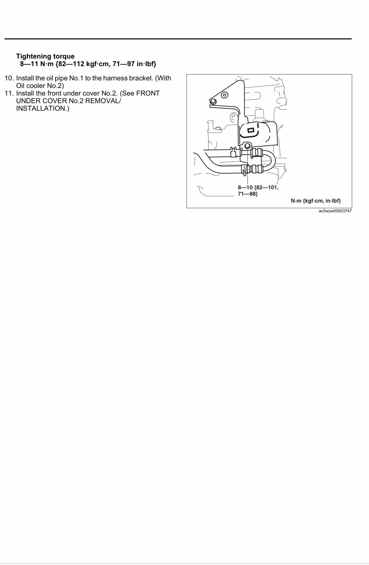

⋯ I'm just curious if there's an official step-by-step out there that instructs how to get to the thing in the first place.
I posted official ATF adjustment instruction for CX-5 by Mazda which includes ATF level measurement in post #25. And here’s the official ATF inspection instruction by Mazda, and both from Anchorman:
You couldn’t see it because the ATF dipstick is blocked by additional turbo plumbing.
Thanks.
I actually grabbed that and saved it a while ago. Looked right past "Remove front under cover 2." I was looking for a pic.
