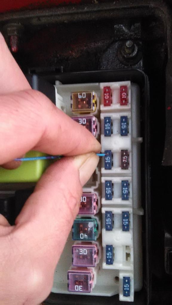

My car was off and I attached one end of that little wire directly to the battery.
I forgot about the little test points on top of the fuses.
My running lights came on.

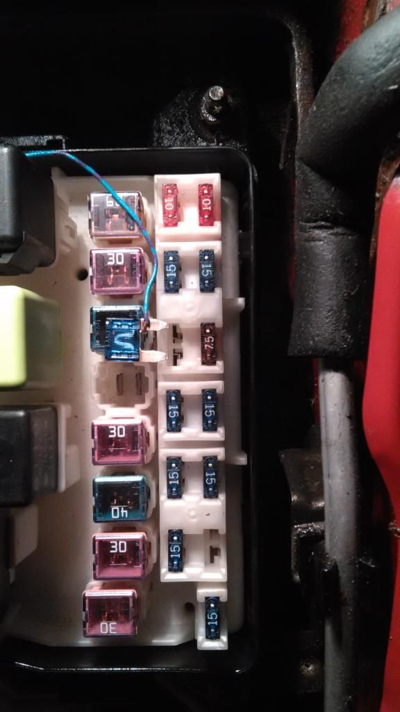

If you are lucky enough to have your running lights come on using the wire, then you can put a wire on the fuse as shown.
Make sure the wire goes on the same terminal as shown so that the battery power is going through the fuse so the circuit is protected.
Just run a wire from the battery (doesn't have to be too thick) to a switch somewhere (there's an empty spot beside the fog lamp switch) then to that fuse.
You may want a second in-line fuse on that wire right at the battery.
(You can just install a jumper wire for the time being so you can drive at night,.. be aware that the wire wrapped around the fuse can kinda expand the connector it plugs into,.. I didn't plug the fuse in for this reason)
You can use a spare fuse cut in half to make a proper fitting terminal connector.

Only my running lights came on.
You can "Jerry Rig" it really easy if your running lights come on.
With the key out of your car touch a wire from the positive battery to the top of the fuse and see if they turn on. Real easy,.. takes two minutes,... I didn't blow anything up so you won't.
